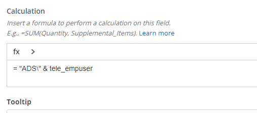

However in Forms you can add a single-line field and use the field formulas to prepend the ADS. You can use the below formula, but replace UsernameField with the variable of the field that gets the username from SQL:
="ADS\" & UsernameField

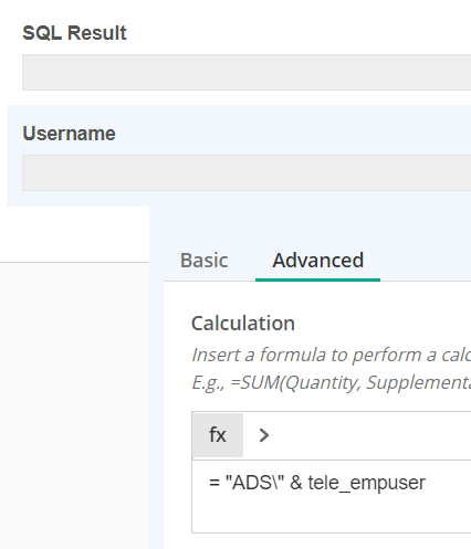

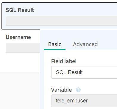

tele_empuser is the field which already has the username from a form lookup. Am just trying to add ADS\ prefixing it.
Tried the below.... not sure if i missed any syntax.... it's not adding the \ADS. Am i missing something? Thanks for your input again!
replied on July 24, 2020
Is tele_empuser the variable name? It worked for me.
Yes Jim, i did some spacing incorrectly. It worked for me. Thanks for verifying!
