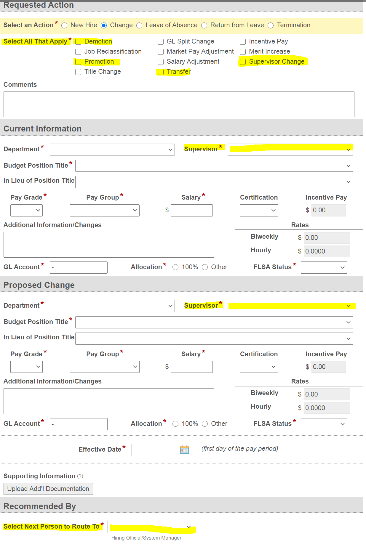

I have two drop-down fields with names which I will use to control the routing of the form (.formersup and .hiringmgr).  Only one of the routing fields should show on the form based on the type of change being requested (.changeaction) and if the current supervisor (.currentsup) and proposed supervisor (.proposedsup) fields do not have the same value.  I was able to control the display of the routing drop-down fields based solely on the type of change being requested, but when I tried to add the comparison of the two supervisor fields the JS broke.  Can someone help me fix my JS to get it to work properly?  Below is the JS that does not work and attached is a snapshot of the form.  Any help is greatly appreciated.

In your line '.currentsup input, .proposedsup input', try replacing the 'input' with 'select'. Dropdowns use the select element, vs input for single-line, number fields, etc.

It appears that the issue is with the trigger event on the drop-down boxes for supervisors.  When I use the JavaScript with single line fields it works.  Does anyone know how to trigger a change event on a drop-down box?  Below is the script that works on single line fields (.currentsup / .proposedsup).
replied on July 24, 2020
Thank you Jim!  You have been a great help and I have learned something new. smiley
