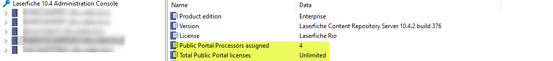

In the Administration Console does it show the Public Portal?
If not you need to go into Directory server and add the server to the WebLink application. Once the server picks up that change you should be able to access WebLink with your public user.
