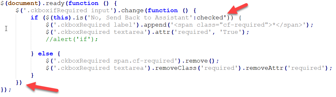

Oh!  Got it!  I removed all of the other JavaScript and tried again and it worked!  Then put back in a piece and it STOPPED working again.
This JavaScript is targetting a different control box, a radio button that again directs the process to different branches but at a later stage in the process.  Any ideas why it would stop the other one from working?
//This is for the 2nd Approver Comments box to become Required
    $('.ckboxifRequired input').change(function () {
        if ($(this).is('No, Send Back to Assistant':checked')) {
            $('.ckboxRequired label').append('<span class="cf-required">*</span>');
            $('.ckboxRequired textarea').attr('required', 'True');
            //alert('if');
        } else {
            $('.ckboxRequired span.cf-required').remove();
            $('.ckboxRequired textarea').removeClass('required').removeAttr('required');
replied on July 16, 2020
I see two syntax errors in that block, so my guess is that this is like point 2 above, which is that if there's a problem anywhere in the JS, it can cause some or all the rest to stop working.
In this case, there's a problem with single quotes in your IF statement. Specifically, your choice is contained in quotes and then :checked ends with an additional one. So that's causing problems.
Additionally, the whole .change function needs a semicolon at the end.
So, the corrected script would look like this?
        if ($(this).is('No, Send Back to Assistant':checked)) {
            //alert('if');
        } else {
