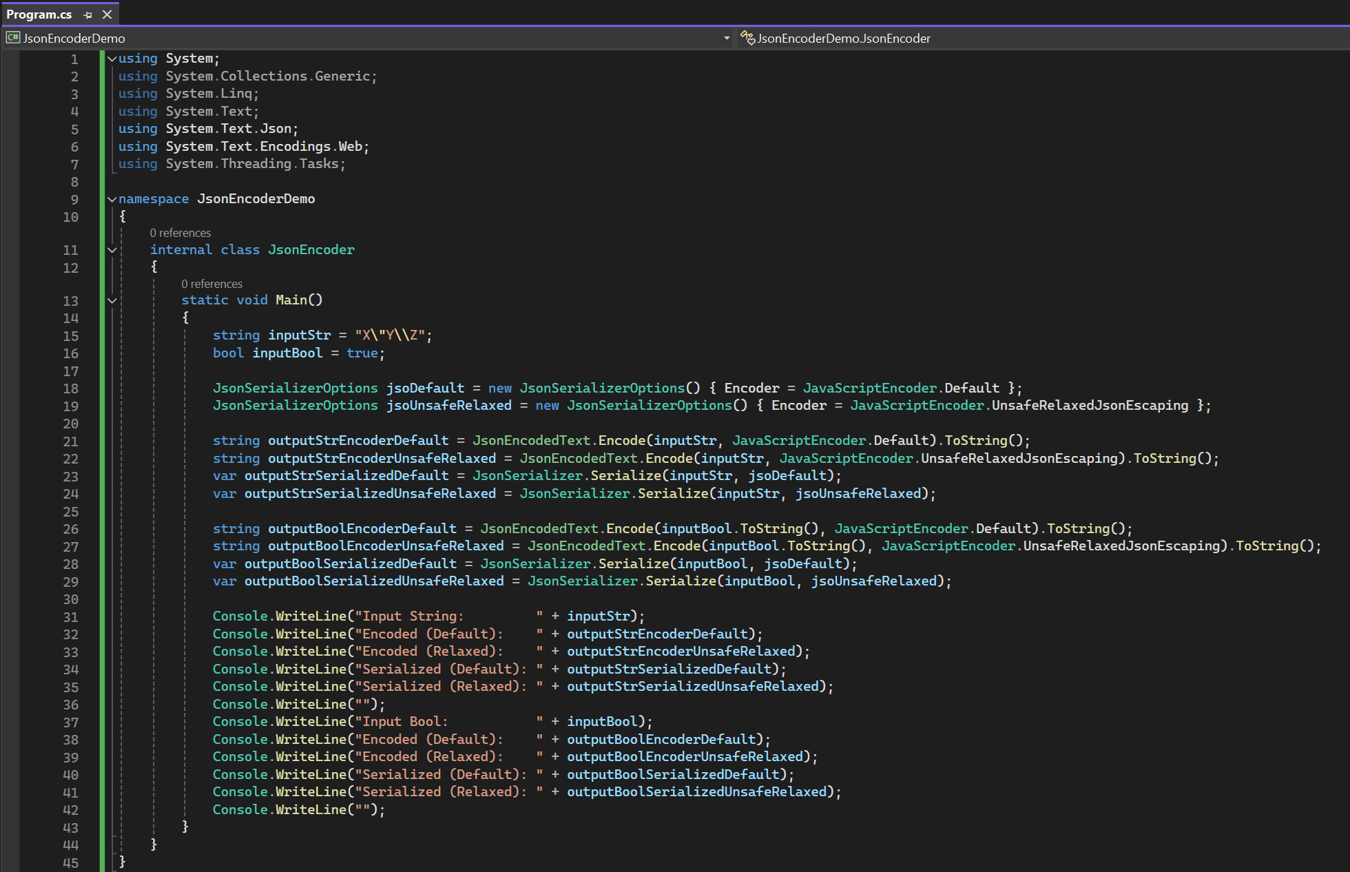

Jason, there are two different standard JSON encodings in the .NET Framework 4.8.1 System.Text.Encodings.Web JavaScriptEncoder class that you can use with System.Text.Json JsonEncodedText.Encode method:
  1. Default
  2. UnsafeRelaxedJsonEscaping
    1. See also: Serialize all characters, especially the "Caution" note

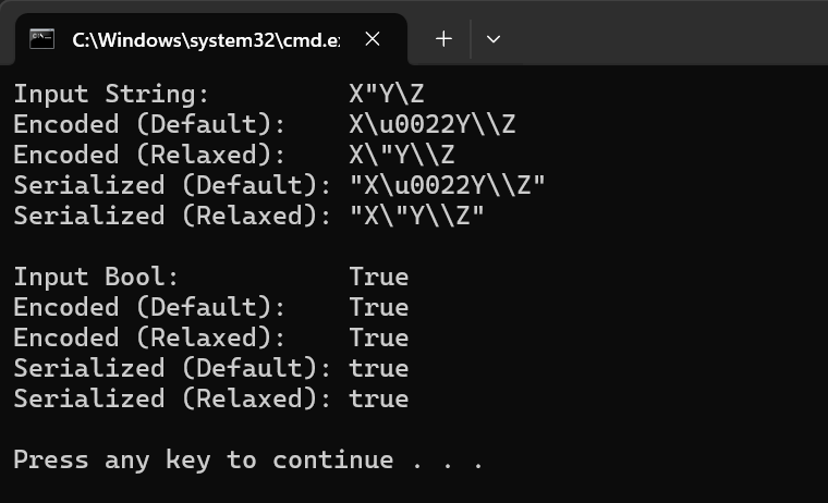

I wrote a quick test program to compare the two with your sample string and a boolean. The Encode() method require string input, and .NET's Boolean.ToString() method returns "True" or "False", so that doesn't help you with the ToLower scenario.
The JsonSerializer.Serialize method returns 'true' as you pass it the Boolean directly without having to first cast it to a string.
What behavior would you expect here?
Output:
Code for reference:
// .NET Framework 4.8.1
using System;
using System.Collections.Generic;
using System.Linq;
using System.Text;
using System.Text.Json;
using System.Text.Encodings.Web;
using System.Threading.Tasks;
namespace JsonEncoderDemo
    internal class JsonEncoder
        static void Main()
            string inputStr = "X\"Y\\Z";
            bool inputBool = true;
            JsonSerializerOptions jsoDefault = new JsonSerializerOptions() { Encoder = JavaScriptEncoder.Default };
            JsonSerializerOptions jsoUnsafeRelaxed = new JsonSerializerOptions() { Encoder = JavaScriptEncoder.UnsafeRelaxedJsonEscaping };
            string outputStrEncoderDefault = JsonEncodedText.Encode(inputStr, JavaScriptEncoder.Default).ToString();
            string outputStrEncoderUnsafeRelaxed = JsonEncodedText.Encode(inputStr, JavaScriptEncoder.UnsafeRelaxedJsonEscaping).ToString();
            var outputStrSerializedDefault = JsonSerializer.Serialize(inputStr, jsoDefault);
            var outputStrSerializedUnsafeRelaxed = JsonSerializer.Serialize(inputStr, jsoUnsafeRelaxed);
            string outputBoolEncoderDefault = JsonEncodedText.Encode(inputBool.ToString(), JavaScriptEncoder.Default).ToString();
            string outputBoolEncoderUnsafeRelaxed = JsonEncodedText.Encode(inputBool.ToString(), JavaScriptEncoder.UnsafeRelaxedJsonEscaping).ToString();
            var outputBoolSerializedDefault = JsonSerializer.Serialize(inputBool, jsoDefault);
            var outputBoolSerializedUnsafeRelaxed = JsonSerializer.Serialize(inputBool, jsoUnsafeRelaxed);
            Console.WriteLine("Input String:         " + inputStr);
            Console.WriteLine("Encoded (Default):    " + outputStrEncoderDefault);
            Console.WriteLine("Encoded (Relaxed):    " + outputStrEncoderUnsafeRelaxed);
            Console.WriteLine("Serialized (Default): " + outputStrSerializedDefault);
            Console.WriteLine("Serialized (Relaxed): " + outputStrSerializedUnsafeRelaxed);
            Console.WriteLine("");
            Console.WriteLine("Input Bool:           " + inputBool);
            Console.WriteLine("Encoded (Default):    " + outputBoolEncoderDefault);
            Console.WriteLine("Encoded (Relaxed):    " + outputBoolEncoderUnsafeRelaxed);
            Console.WriteLine("Serialized (Default): " + outputBoolSerializedDefault);
            Console.WriteLine("Serialized (Relaxed): " + outputBoolSerializedUnsafeRelaxed);
Some good related discussion on Stack Overflow here:
c# - dotnet core System.Text.Json unescape unicode string - Stack Overflow
replied on August 22, 2024 Show version history
I suppose the Encode method wasn't an ideal example since I was thinking more about the output in specific scenarios.
Serialized is more accurate, but really I'm just after a way to ensure tokens are in a valid JSON format rather than being output as any particular data type (i.e., true/false/null vs True/False/[NULL or empty]).
I wouldn't expect full serialization of complex objects or anything like that, just a way to ensure the following:
  1. Boolean values return true/false (null when empty)
  2. Reserved characters are escaped in string/text values
I think what changed after the update is that I used to get true/false but now I get True/False more like .ToString() in .NET.
In the past I've gotten around the default ToString behavior when setting input values or dynamic JavaScript in .NET MVC views with JSON.Encode like:
Serialization could be overkill for the boolean since all I'd really hope for is a way to ensure it returns true/false/null so the resulting value work in the JSON when:
  1. Has the Boolean tag set
  2. Has a JSON format applied
