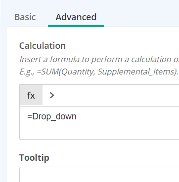

This is a limitation of web browsers. The element that acts as the dropdown cannot display multiple lines, similarly a single line field cannot either.
A workaround is to add a multi-line field below it and use the field calculations to make it equal the dropdown field. Add the following to the multi-line field, replacing "Drop_down" in the below screenshot with whatever your dropdown variable is:
replied on July 7, 2020
Thank you! This might work!
