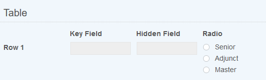

Since it is in a table, you need to go through the rows of the table.  the below example assumes you have assigned the table a class of "tableClass" and my table is

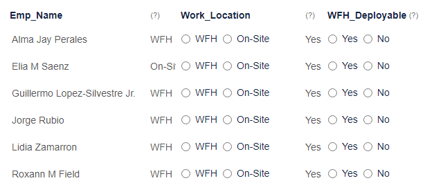

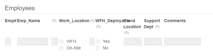

replied on July 10, 2020
Here's how it looks in the designer (column 3 is the one with the variable _LocationText):
Here's how it looks in the preview (Column 2 is _LocationText):
Column 6 is the other one I want to auto-fill based on the value of column 5.
