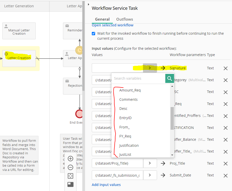

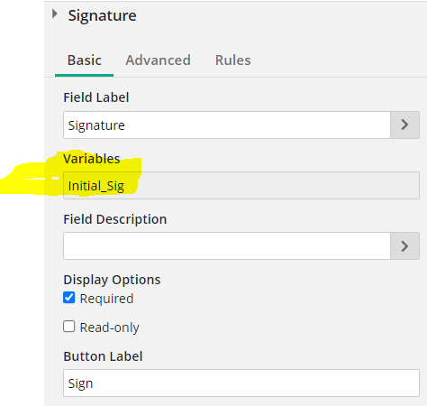

To follow up on this post, it appears there is a distinct lack of functionality between the Retrieve Business Process Variables activity vs the Cloud approach.  For example, Signature fields seem to be a big gap. I'm currently trying to merge a Signature field from a Form into a Word Document, but I am unable to map the Form Variable into the Workflow Parameter - it simply doesn't show as an option in the Process properties.
Am I missing something? Any assistance would be greatly appreciated.
Screenshots of Signature variable and inability to select in within process properties.

No, I have not yet come across any way to move the 'Signature' variable around in a Workflow. To my knowledge, it's still undoable.
You can pass variables through from a Business Process to a workflow by mapping them all as Input Parameters, but I haven't seen a way to map/move/use the Signature piece. I imagine it may have something to do with the legal requirements for digital signatures, as moving one after signing may be construed as invalidating it.
We have managed to work around this by placing signature blocks inside our Word Templates when creating letters/documents that way, and we've also begun using a third-party digital signing service that integrates with Laserfiche Cloud as well. These seem to work well, but I'm curious if Laserfiche has any plans to expand on the Signature fields flexibility/usage in other automation pieces.

If you really need this feature, There is a workaround.
You can use jQuery on the classic form to get the "data:image" from the signature field and store it in text field and pass that value to the workflow.
You can embed this value into the word file using Mergefield "Image:image".
