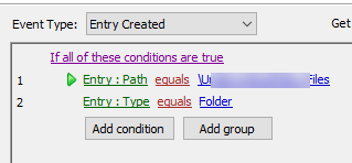

I have a Workflow process that should execute whenever a subfolder is created in a specific folder...here are the conditions.

I have a workflow process that is conditioned to execute when a folder is created in the \rootfolder\parentfolder folder (let's call it CreateFolders).
I have another workflow process (call it ProcessDocument) that moves a document into folder \rootfolder\parentfolder\childfolder\grandchildfolder.  Assuming childfolder does not exist when ProcessDocument workflow is run, then I would expect the CreateFolders workflow to execute because the childfolder folder is being created as part of the Move Entry workflow action in ProcessDocument workflow.
As a test I also added a Create Entry action in the ProcessDocument workflow to create the childfolder before it moved the document.  Even this did not execute the CreateFolders workflow.  If I go into Laserfiche and manually create the childfolder folder then the CreateFolders workflow process does execute.

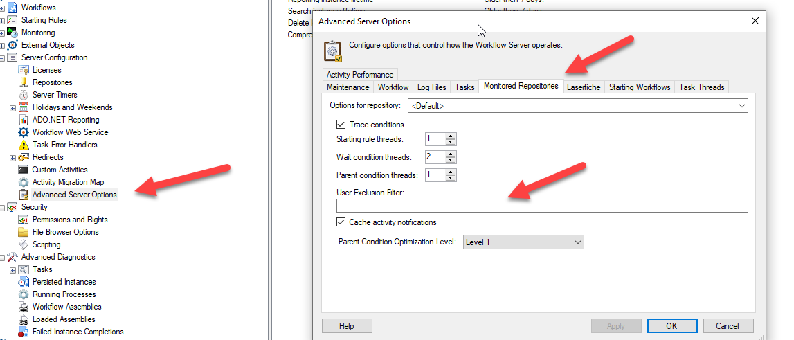

It's possible the account associated with your Workflow profile is being excluded from monitored activity in the repository. It's not a default option, but it may have been set up in your case. You would see it in the Workflow Administration Console under Advanced Server Options.

That was exactly it...removed the Workflow user from the exclusions and bam!  it works!
replied on June 30, 2020
Be VERY careful with this, or you may see negative effects. Workflows looping between each over and over..
You could removed the User from the exclusions, but then add an exclusion to your Workflow Processes like (When USER NOT EQUAL "WF") except on the one(s) you wish to still run.
