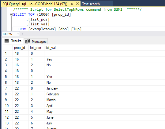

Hey Glen,
It looks like the list values are stored in the [lup] table in your repository database. You could push the information directly into that table but doing things like alphabetizing might be difficult. And since this isn't a supported method of inserting data to field lists, you'll want to take backups of your environment early and often.
I know you said you can't use an external DB, but that really is the only good way to do what you need. Since you already have a SQL server on premises to host Laserfiche, you might be able to get away with adding a new DB to that server or even adding a simple table to an existing DB on that server for your dynamic field.
