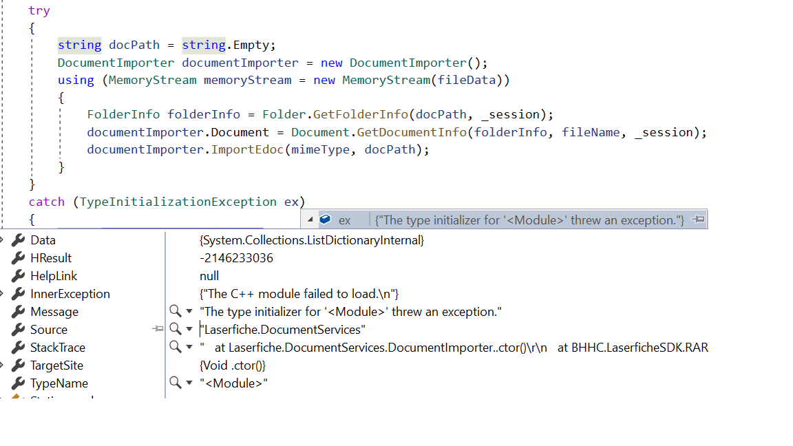

I am developing a .NET Standard 2.0 library to upload documents to a Laserfiche repository.
Get an error on the DocumentImporter constructor line: The type initializer for <Module> threw an exception.
Laserfiche SDk V10.2
Checked the GAC and the Laserfiche dlls are present.
Have read on this site regarding using Process Monitor. Followed the steps but did not see anything relevant.
Any help or ideas is much appreciated.
Screenshot of the error is attached.
Thanks!!
