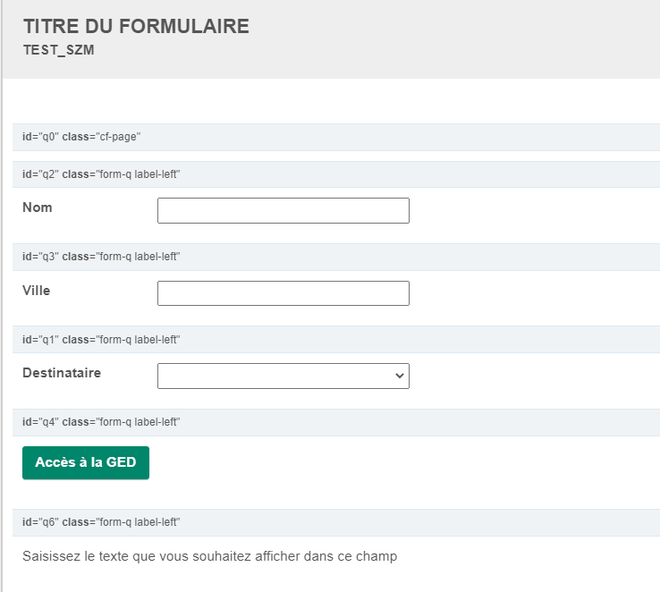

I have a script that retrieves links from the Laserfiche repository.
These links are added to the form. $ ("# q6") .append (sURL);
The links are formed as follows: '<a href="' + sPrefix +'">' + sName + '</a>'
where sPrefix = http: //myserver/laserfiche/DocView.aspx? repo = XXXX & docid = '+ sId
When the form is submitted, the links are gone.
An idea of what's going on.
The code used

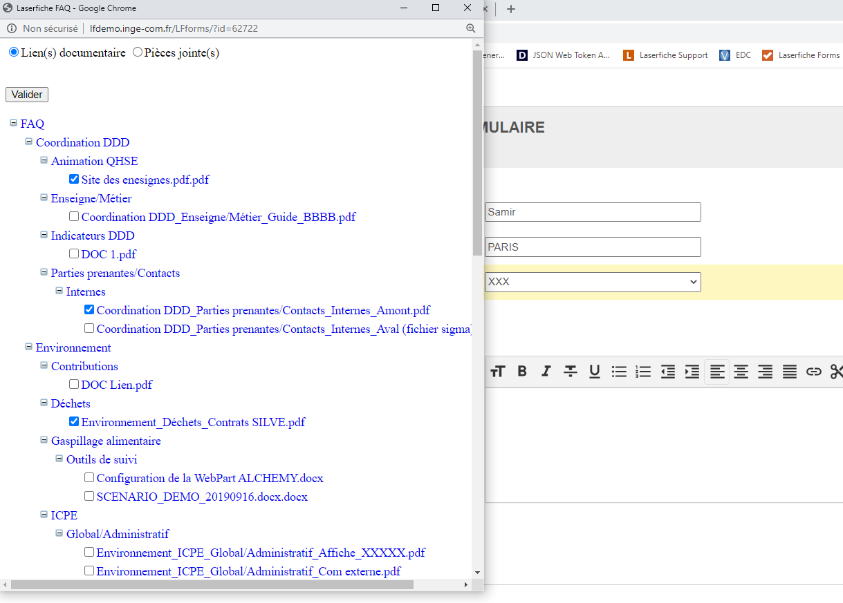

Hi Jim, Jason,
Indeed, there is no user input.

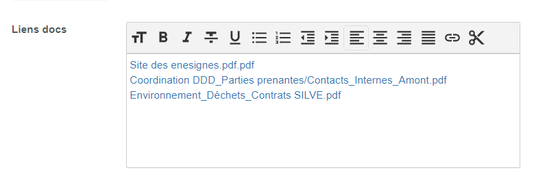

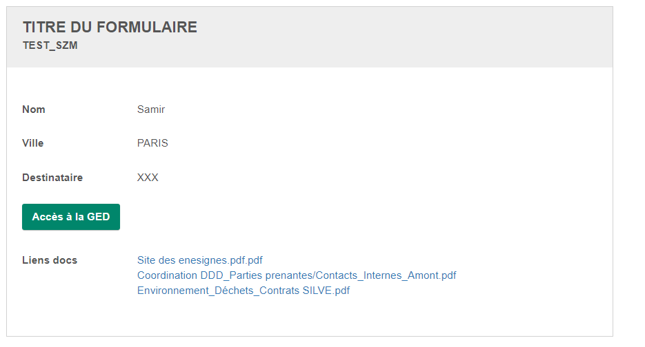

To work around the problem, I use rich text which I feed with links.
It works perfectly.
Attached is the code used.
