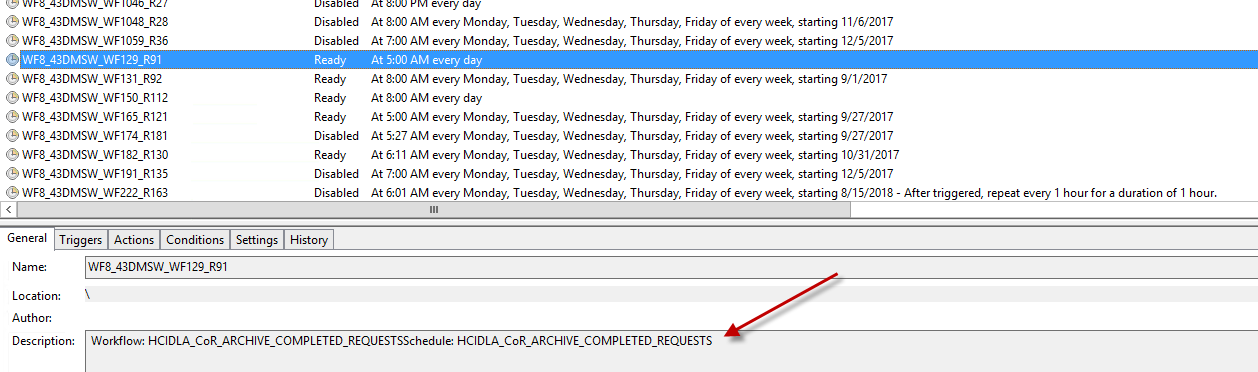

Hi Ege!
This isn't a calendar, but may speed up your investigation:  when you create a scheduled workflow, Laserfiche actually creates a scheduled task on the server, prefaced by "WF".  From there you can focus only on the scheduled ones, and have fairly quick overview of what's going on.  Highlighting each one will tell you its name in the description.  Word of caution - I have seen instances where the scheduled workflow was removed, but the scheduled task was not - usually when I've deleted a workflow.  You'll see an error in the Event Viewer that the workflow was not found.
Hope this helps!
