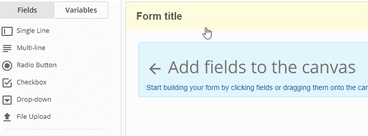

I am using 10.4.1, here is an example where I provide no variable name, so that one is automatically generated on save. This is where I am confused, if the variable was named My_Field wouldn't the title have to be "My Field" when the prefab is saved? Where is it getting "Single Line" from? That was a state it was in well before it was ever saved.

Chad I notice you're deleting the field from the first form before dragging it onto the second form. Try doing the same but without deleting it from the first form.
I've had this issue in the past when the variable is not on any forms before dragging it onto a new form. It almost seems like the label and such are stored only on the form, and copying the variable onto a different form will only copy the field's config from the original form (which, if it isn't on there, will not exist).

It's confusing. If a variable is no longer on any forms, it loses all its configuration except for the variable name. Hence "Single Line" with no other settings set.
If the field still exists on another form, it will pick up the configuration from that form, including the displayed field name.

Ah, sorry, didn't realize you were deleting the field on the first form. The variable name is the only thing truly saved to the process. The rest of the configuration (display name and all the settings) is saved per form. When you drag on an existing variable to another form, we use the most recent saved configuration for that variable. For instance, if you set up a field on form 1 then drag it onto form 2, it'll default to the form 1 settings. If you then change the config on form 2 and drag it on to form 3, it'll use the form 2 configuration as it was the most recent save.
Deleting the field will delete the configuration so the only thing that carries over is the variable.
