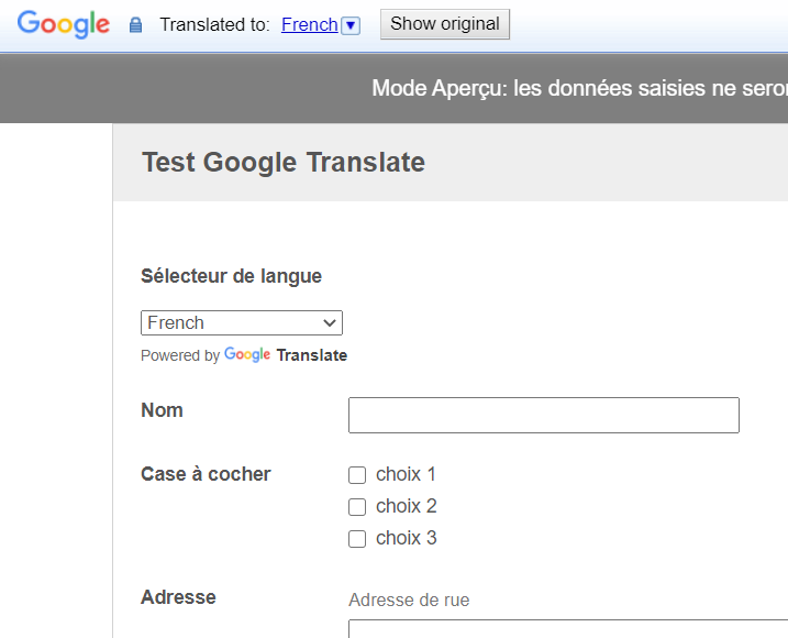

Hi Manuel,
You can use the Google Translate API to translate the form dynamically.
Add an HTML element with the following. This will have the dropdown menu with the language.
<div id="google_translate_element"></div>
Then, add the following JavaScript (replace the 'en' in {pageLanguage: 'en'} with the original language's two letters, if it's not English):
$.getScript("//translate.google.com/translate_a/element.js?cb=googleTranslateElementInit");
function googleTranslateElementInit() {
  new google.translate.TranslateElement({pageLanguage: 'en'}, 'google_translate_element');

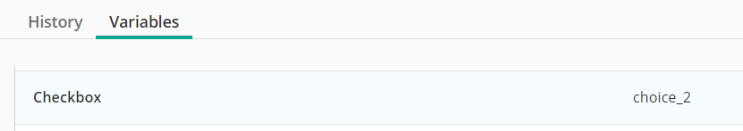

Due to how Google Translate handles translating the page, all of the variables like checkboxes or radio buttons will remain as the original language (excluding text boxes, obviously).
13 0

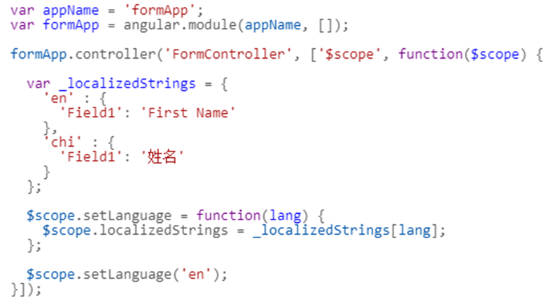

One way to implement translation is to consider using the AngularJS framework to simplify the code creation. Some quick code snippets walk-through of this step up:

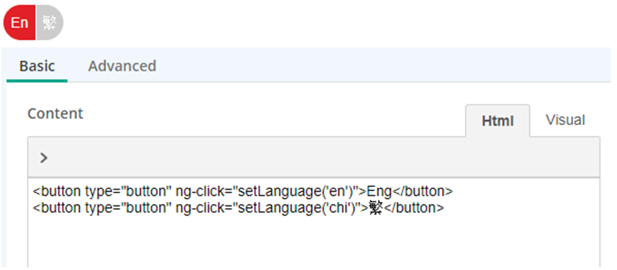

  1. Add a method to choose between the languages using Custom HTML with some CSS (Screenshot 1).

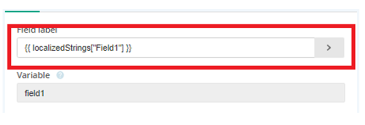

  2. Add Fields to the Forms Layout and name the string using the NgBind directive (https://docs.angularjs.org/api/ng/directive/ngBind) (Screenshot 2), it can bind the translation strings to a Variable defined in angularJS.
  3. After the binding is set up, you can add a function to trigger the translation by setting the correct localized string to the variable based on the language selected (Screenshot 3). This can be done using the Ng-Click directive.
  4. One thing to note is angularJS is not used by default in the Form customization. So, you need to load the angular js file by jQuery.getScript. After the angular script is loaded, you need to do the bootstrap manually so that angularJS application can be initialized.
In the code snippet below, the scope is an object that is used for the binding between the view and the model. You can either use controller or directive to access the scope. For starter, I would suggest to start with controller.
