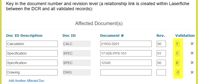

The user provides info in a table:

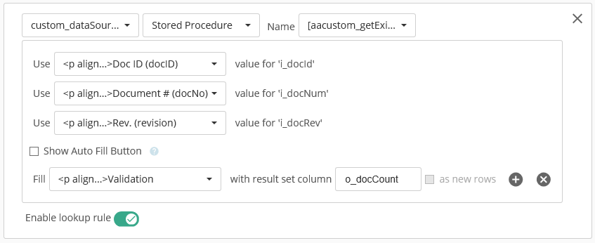

That validation field is filled in via a stored procedure that queries Laserfiche:
If the record (Doc ID + Doc No + Revision) are in the system, it returns a "1", otherwise, it returns a -1 or 0. This has been made available but not required. Now I'd like for the user to receive a message when the number is NOT a 1. Any ideas on how I could go about that? Here's what I've tried so far:

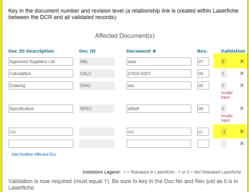

replied on June 12, 2020
Hmmm, still have an issue. I put:
But don't know why the highlighted items below are not errorring out:

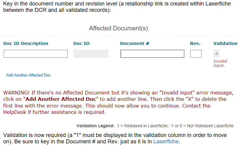

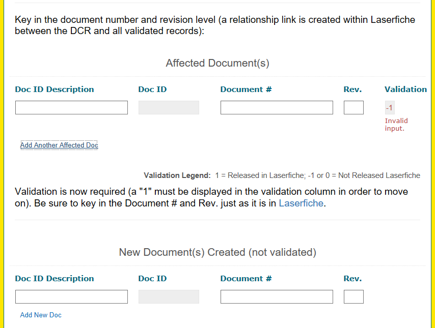

So, small issue. A user puts data in that table by mistake (they wanted to put their data in the table below). They delete it, however, there's still a validation going on that causes the user to not be able to continue:
Here's what I thought would solve the issue, but it doesn't.

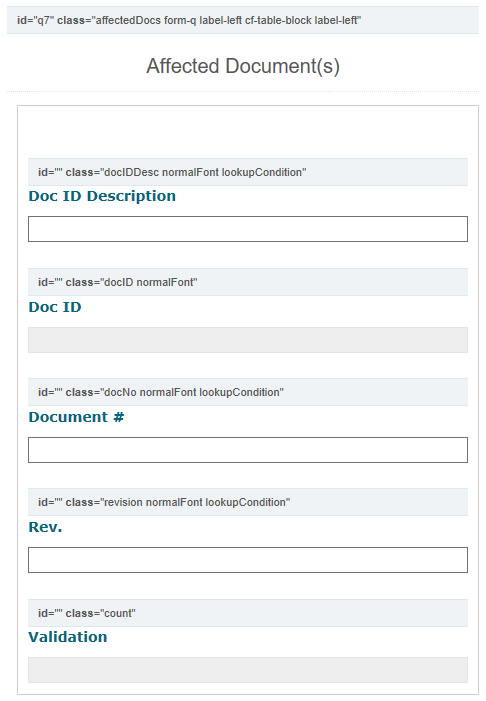

replied on June 18, 2020
That's odd, the lookup should run again when the value is cleared out, which should update the value of the validation field.
Do you get any errors in the console?
You wouldn't necessarily want to use $('.count input').val('') anyway because that would affect the entire column, not just that row.

replied on June 23, 2020
That's a fairly common warning/error so it shouldn't be related.
I'm a bit stumped. If there's no related errors in the console, then there shouldn't be anything "breaking" with your code.
To troubleshoot and help narrow things down, I'd add the following to the form to monitor when your lookup events are actually firing.
  $(document).on("lookupstarted", function (event) {
        console.log('lookup started: ' + event.triggerId);
  $(document).on("lookupcomplete", function (event) {
        console.log('lookup completed: ' + event.triggerId);
replied on June 24, 2020
@████████, thanks so much for all help in trying to solve this issue. The validation does work when it is changed. I think it just a bug that it doesn't "clear". That said, I have found an acceptable workaround as it really doesn't happen too often.
I set up a field rule that will show message in maroon when the validation doesn't let the user continue due to a validation field that won't clear:
