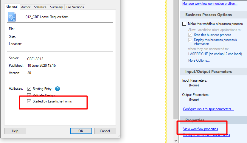

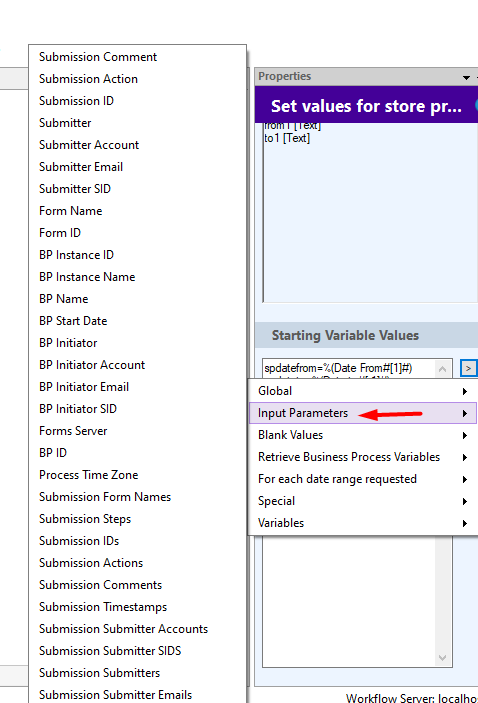

Hi Jain,
Yes.
Through workflow, make sure that you enable "Started by laserfiche Forms" in workflow properties.
And use "Input Parameters" as token value.

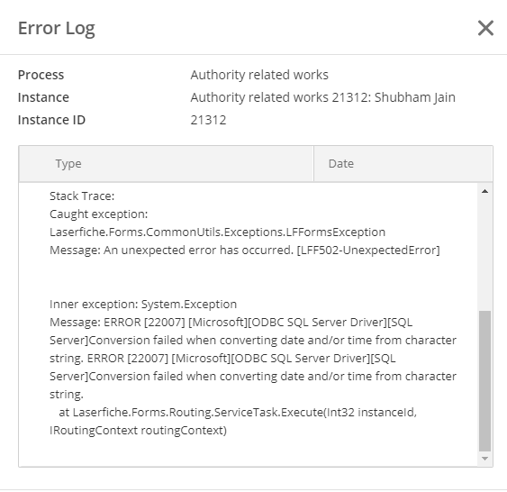

Hi Mahesh,
I have done with your suggestion but when i am trying to submit the task WF gives the error.
In this error i also check with data type of nvarchar and varchar.
Screenshot attached.
replied on June 14, 2020
If you are inserting a date field, please make sure that you apply the correct formatting.
Thanks.
replied on June 15, 2020
Hi Mahesh,
Hope doing well !
i have tried with these three formatting i.e.:
(1) YYYY/MM/DD
(2) DD/MM/YYYY
(3) MM/DD/YYYY
but still issue remain same.
Any solution on this ?
Thanks
Shubham Jain
OK, please send a screenshot of the workflow.
I assume that the screenshot above is a Save to Repo task.
Thanks.
