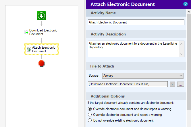

It depends on what all needs to be copied over, but if you just need the electronic document you would first use the Download Electronic Document activity on the source entry, and use the result file in an Attach Electronic Document activity on the target document.
However, if the target document already has an electronic file, this would overrwrite that file.
replied on June 9, 2020
Let me give this a shot and I'll get right back to you.
