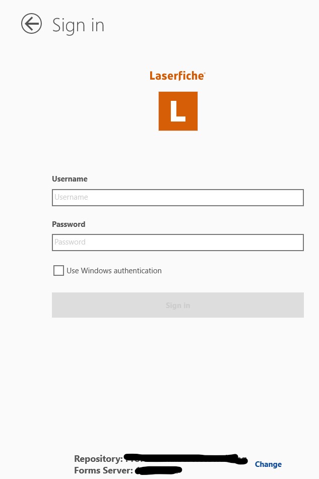

When logging in at the bottom of the screen you should see something like the following with a change button you can click:

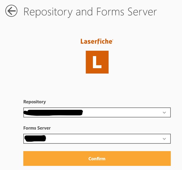

After click on the change button make sure that the correct Forms server is selected.

I only see 'Repository' at the bottom, no form server at all. I clicked change and surprise 'Form Server' is set to None. I change it to my form server and then a new screen pops up asking me to login. I key in my username\password and then it comes up with an error about the user name being blank. If I hit OK it goes back to beginning. If I hit 'Cancel' I am able to key in the username password again and I am in. Unfortunately I now get a popup saying 'Error Unexpected error' and I have to click 'OK' multiple times to have it disappear. If I click on hamburger icon, I do see my forms stuff but if I click on any of them I get the 'unexpected error' message again.
If I close the mobile app and restart, the form server has disappeared again from the change option.
replied on June 5, 2020
