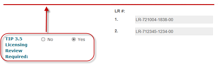

I'd like to top align these two fields using TwoPerLine:
Here's what I have so far:
/*Displays two fields per line*/
.TwoPerLine{display: inline-block; width:47%;}
.TwoPerLine .cf-medium {width:97%;}
Thanks in advance to anyone who can help!

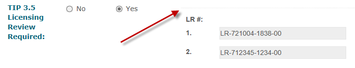

replied on June 4, 2020
Hi Gloria
Add vertical-align:top to your css code as in the example below
.TwoPerLine{display: inline-block; width:47%;vertical-align:top;}
Can I tell you that I tried that! I copied and pasted what you put up there and IT WORKED! Imagine that. I obviously didn't have it 100% correct! Sheesh.
Now if I could remove the line that is there (I'm not using a heading, but the line still shows up).
Hi Gloria,
Your best friend in these situations is the developer tools in the browser.
Right-click that line, or as close as you can, and select "inspect" and then you can find the class you'll need to be able to make it hidden.
I'm pretty sure it is something like .cf-table-header, but I figured it would still be helpful to point out the "easy" way to track those things down since in my experience this kind of thing comes up a lot.
Usually you will need to combine that with another more specific selector so you don't end up applying it to every one of those elements, but you get the idea.
