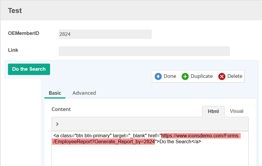

I'm trying to create a button to open another Forms Business process using a variable from the first Form.  The value that I need to change is the 'href' in the HTML.
How I can replace the https reference in the HTML using the value on the Link field?
Below are the HTML value and the preview of the form process where the Link value is displayed.

Is there a reason you're putting the link into a field? The solution is going to depend on when your variable is populated and when/where users are going to be using this link.
If the value was saved in a previous step, you could just put the variable in the URL.
However, if the value is populated/updated on the same page that has the link, you would need to use javascript, and it could be done a couple of ways.

There is not a reason to put the link into the field, it was only to be able to confirm that the link value retrieved the OEMemberID value.  I know that to update the HREF value I will need to use javascript but I have tried several ways to do that and not able to properly do it.  I appreciate your help if you have a sample.

To be honest I wouldn't bother with changing the link at all. You already configured your a tag to look like a button, so just make it a button and handle everything in JavaScript.
First set a custom CSS class on the OEMemberID field, or get the field ID, which will be shown above the field in the right pane when you open the CSS/JavaScript editor.
The ID of the parent would be something like q1, q4, etc., and the field ID would just replace "q" with "Field"
I prefer to use classes because it is easier to move things around without having to go in and change the JavaScript.
The button:
<button id="testBtn" type="button">TEST</button>
The field:
The JavaScript:
$(document).ready(function(){
  $('#testBtn').on('click',function(){
    var URL = 'https://www.test.com?' + $('.testField input').val();
    window.open(URL);
3 0
