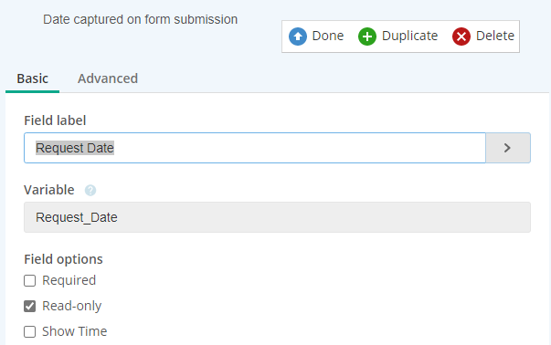

I have a form that requires two different levels of signatures. At the bottom of the form, I have a signature field and a date field which is set to read only and a default value of "current_date". I thought this would populate the date field with the date that the user completed the form, but it's populating instead with the date that the task was initially assigned to that user.
How do I go about creating a date field that populates the current day upon form submission? I'd prefer the individual not have to select the date manually. Sometimes there is a day or two between when the form is signed by both parties and I'd like to accurately track the date that the signature was obtained. Thanks!

When a date field is set to "current date" and read only, it should display "Date captured on form submission"
If you're using the same form for both tasks, it would explain why the date is being populated, and to get around that you'd either need two different versions of the form or find a way to prevent the first task from saving a value for that second signature date.

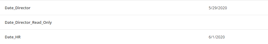

3. The value for the Date_Director (sorry I misspoke earlier, this is the same as Director_Date that I have been referring to) variable is accurate:
4. I don't. I just was trying that as a potential workaround to make this work properly, which clearly didn't work.

Are you absolutely sure they are both using the same variable (double check the variable name on the second form, not just the label)?
There has to be something else about your configuration that is causing the problem because if the variable is populated, and you're using the same variable on both forms, there's nothing in your process that should cause it to not be populated.
In the screenshot you sent earlier it definitely showed that a value was saved to the variable, so if that variable was placed on a subsequent form I don't see any obvious reason it wouldn't have the value from the previous step.
