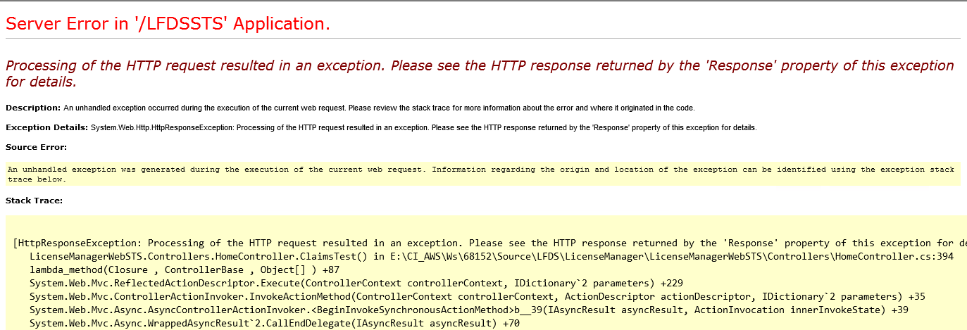

Going to slip in one more question.  I came across the STS Claims Testing Page section in the LF Admin Guide.  It says to navigate to https://STShostname.SampleDomain.com/LFDSSTS/claimstest after signing into an LF app via Directory Server.
I tried this on the Web Client server and got a generic "An error has occurred" message.
I then repeated this test on the Directory Server itself, and got a more detailed error message which I cannot decipher (see attached).  Could this be an indication that STS is not actually setup properly, thus leading to the initial problem?

replied on May 27, 2020
What version of LFDS / STS are you using?
We're on 10.3.0.
Ah okay, the claims test feature is not exposed for versions prior to LFDS 10.4.3 (I'll make sure that documentation page gets updated). I believe you should be able to enable it by adding this key to STS's Web.config under "appSettings"
<add key="EnableClaimsTest" value="true" />
Thanks Chase, the Claims Test is working now on both servers.
