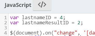

Hi Dylan,
I'd recommend using JavaScript. The in-field calculations are likely not advanced enough for comparing the values of every row in a table.
Create a hidden field that is not read-only, and set your field rule to show the Special Remarks when the hidden field is "Different". (You may have already completed both of these steps if you were testing your example field calculation.)
Then, add the following JavaScript and change the question mark in the first line ("lastnameID") to the column's ID number, and the question mark in the second line ("lastnameResultID") to the ID of the hidden field that triggers the field rule from my previous paragraph.
var lastnameID = ?;
var lastnameResultID = ?;
$(document).on("change", '[data-col="q'+lastnameID+'"]', function() {
  var different = false;
  var valFirst = "";
  $('[data-col="q'+lastnameID+'"] input').each(function() {
    var val = $(this).val();
    if (valFirst == "")
      valFirst = val;
    else if (val != "" && valFirst != val)
      different = true;
  var diffText = different ? "Different" : "Same";
  $("#q"+lastnameResultID+" input").val(diffText).change();
FYI you can find the ID of the column by right clicking on one of the column's fields and choosing Inspect, and then in the HTML it's the number between "Field" and "(" in the "id" attribute. So for example in this:
The field's "id" attribute is "Field4(1)", so the column's ID is 4.
