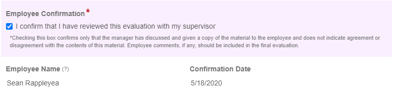

I have an evaluation form where the user has to acknowledge that they have reviewed the form, then the system populates the subsequent name and date fields with the current user and today's date, respectively (Actually, the default value of the date field is captures on Form submission, which is what I want, but you get the idea).
Here's a visual:
The problem I have is that there is still one last chance for the document to be returned to an earlier state after this if some kind of error or problem is discovered.  Once the Confirmation Date, in particular, is set, I can't get it out!  So if the document gets returned for correction, when it gets back to this state, the Confirmation Date field is already populated with the old date, when it needs to revert back to it's original setting of capturing the date upon form submission, or at LEAST being reset with the date that the Form was loaded.

Hi Sean,
Is your date field read-only? I've had issue in the past with changing the value of a read-only field.
If so, what you can do is remove it being read-only, then set the read-only with JavaScript. Then, when you ant to update the field with the current date, with JavaScript make it not read-only, change the value, and then read-only again.

replied on May 27, 2020
Hi Blake,
This is along the right lines, so I marked it as the answer.  To be more complete, what I ended up having to do was un-mark the fields as "required" in the UI, then set them as read-only / disabled through javascript, then use javascript with a .change() function to save the changes upon rejection.  Thanks for the help Blake and Joseph!

Hi Joseph,
The date value was entered previously, then the process was returned to an earlier step and when this form is revisited, the pre-existing date value needs to be updated to the current date.  My intention is to either:
a)  Remove the existing date value to return the field to it's default state (date captured on Form submission) or
b) If unable to do a, set the date value to today's date through JS
I agree that the code you put in SHOULD work, but the problem I'm having is that nothing I do changes that value.  I've checked and re-checked many times that I'm referencing the correct ID, but for example I just tried running this line:
$('#Field333 input').val('05/20/2020')
and then this line:
$('#Field333 input').val('2020-05-20')
based on the format of the field's min-max values, and I get nothing.  No change.  No errors in the developer console either.  I can't figure this out.
