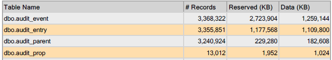

replied on June 9, 2020
Hello Miruna,
Below are the three top table entries. As you can see it drops off after the Parent table
Most of the audit events are entry events, which is normal for production repositories.
I think I'm seeing the misunderstanding. Are you thinking that the 10 GB of disk is for 5 hours of audit events? You have told AT that you want to be able to run reports on 30 days of audit data, and it is loading data from the last 30 days into the database. The configuration UI should show what kind of progress it is making through those logs, and from there you can extrapolate. It's not perfect, but you should have an idea if it's going to get close to 135 GB again.

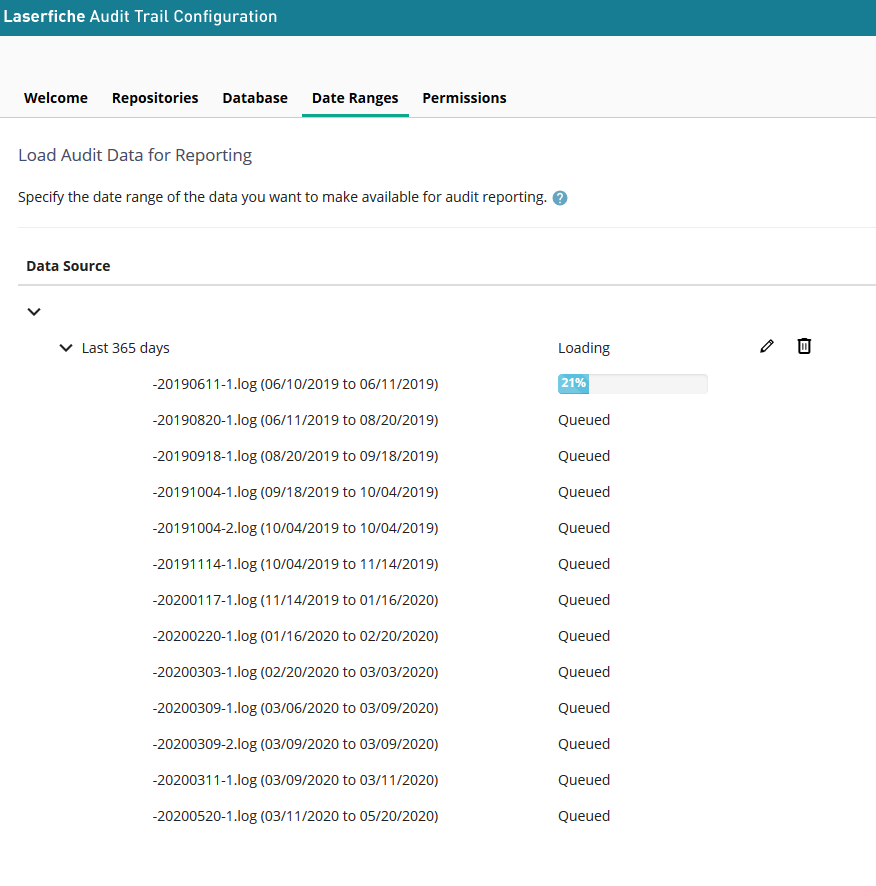

replied on June 10, 2020
It would be under Date Range. You should see a node for each repository and underneath it the ranges you specified and the number of logs that cover that range and how many of them have been loaded in the DB.
replied on June 16, 2020
Hello Miruna/Brian,
Customer sent a screenshot and all I see is Last 30 Days and it is Queued.  There are now sub entries.
Now since the service is turned off, we would not see anything loading correct? So to truly check this, should we start the service and see if we get a loading entry with %?

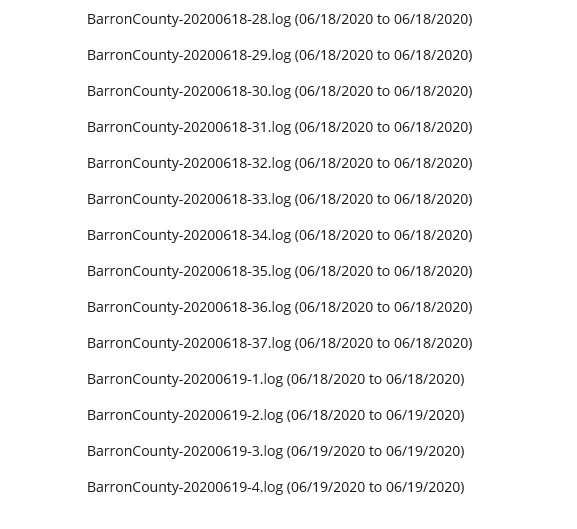

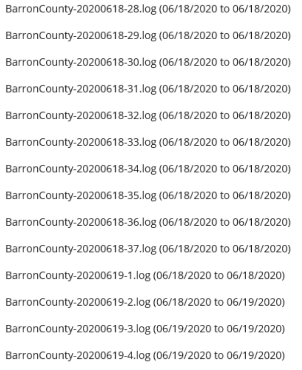

replied on June 19, 2020
Hello Miruna,
After restart of the AT Service below is what he shows after a 90min run
So it looks like a lot of log files being created that need to be deleted, correct?

replied on June 22, 2020
No, deleting the log files would destroy the audit data. A large number of log files could be an indicator of a busy repository. Or it could be a sign that the rollover size for the logs has been set too low.
It's probably best that you open a support case so we can take a closer look rather than guessing from screenshots.
