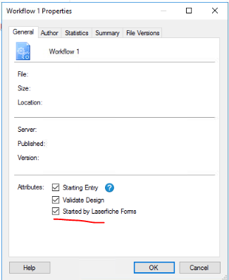

When Forms starts a Workflow, you can easily capture this information by setting your Workflow Properties to Started by Laserfiche Forms which gives you a new menu about the process that started it

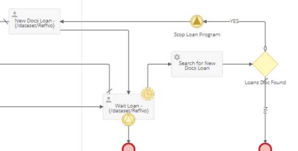

The way I have approached this in the past, is in the Initial Form Process, is to have a timer event that will run a workflow to check the Repository for the Public Form Submission and then grab the data from there to update the Form in process. When you save the Public Form, you can either save the data required to a Metadata field or to save the InstanceID into a MD Field which you can use as a variable to query the form data from the DB
An example of a Process may look like this to trigger the workflow
I have a variable call DocFOUND in my Form that gets updated with either YES or NO, which is used in the condition after the workflow. If yes, it updates the form, If no it stops and does nothing. The Timer does not Interrupt the process, it is set to repeat, which is why if NO do nothing and the workflow will trigger again on the next cycle. When it is found I kill the task with a Signal Event and then raise the Task again but this time it has the new task populated from the workflow

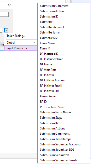

To Get to the Retrive Field Value I had to use the Token Dialog as it doesn't show up in the Activity Dropdown natively.
