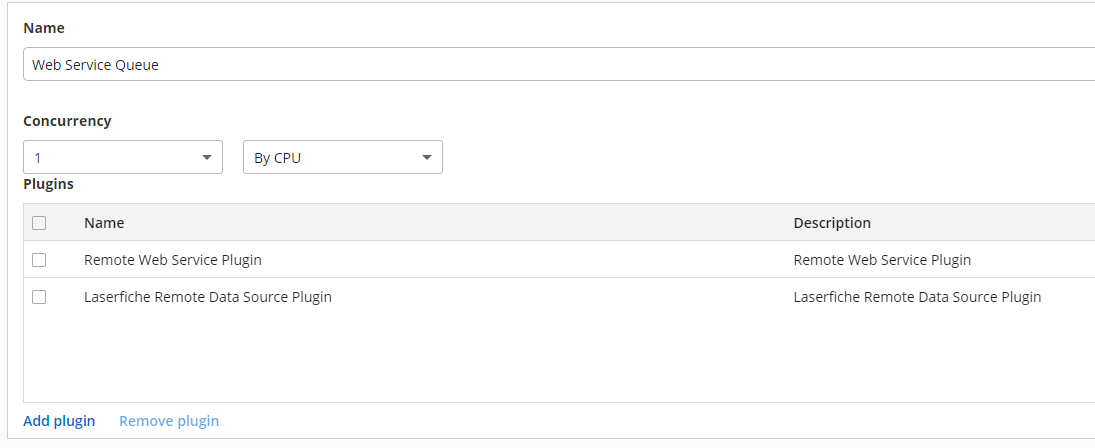

1) Set up a Remote Agent Worker on the machine running the workflow server. Ensure that you add the "Remote Web Service Plugin" to your Remote Agent's Queue;

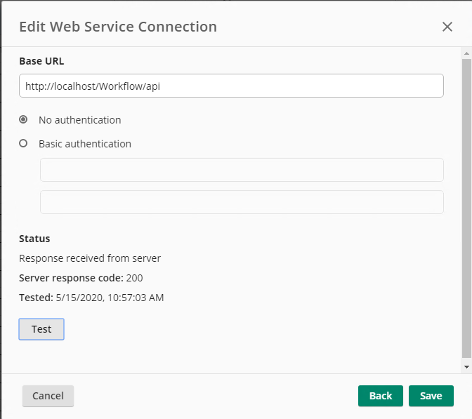

 2) Set up a Web Service Connection (on the Integrations page in PA below Remote Agents tab) using the remote agent you configured, with the Base URL http://localhost/Workflow/api/ . When you click "test" you should get a 200 response code back;

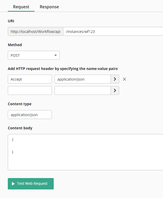

3) Create the web request to start the workflow (Rules > Web Request). I made this simple one below that starts the workflow named "wf123" without passing any additional data, but you can include whatever information you need in the body

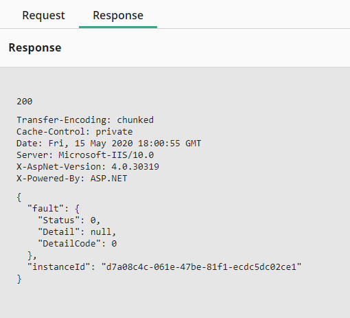

When you test you should get an instance ID back. Note that this will actually run the workflow..

My server response is 401.  I have tired "No Authentication" and "Authenticated" methods.

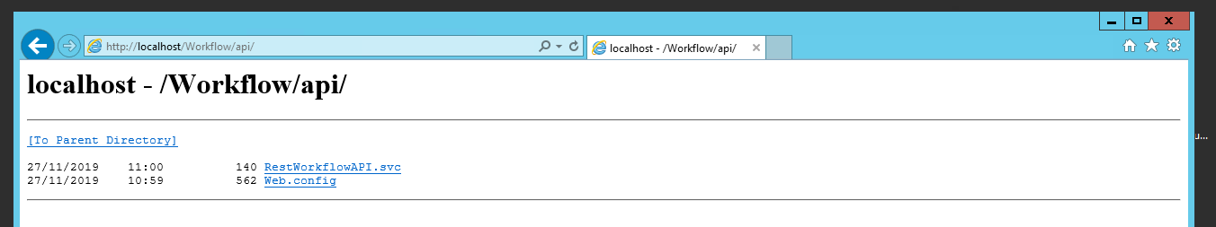

Are you able to access http://localhost/Workflow/api directly from a browser when you are logged into the machine where you installed the remote agent?
replied on May 18, 2020
Yes I can.

No.  I have 1 Remote Agent running on this server with 2 queues (LF Remote Data Source and Remote Web Service)

We can't use "Anonymous Authentication" as this server is also our Web Access front end website.  The authentication I am using is Windows Authentication.  My credentials are correct but I still get the 401 error.
replied on May 19, 2020
When you are adding credentials to the Web Service Connection those are the credentials that will be used to access the web service. You should not need to add credentials here because the remote agent is connecting directly from the local machine.
That said, adding credentials to your Web Service Connection in this case shouldn't prevent you from being able to connect successfully.
