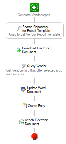

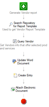

Workflow I am using is shown below

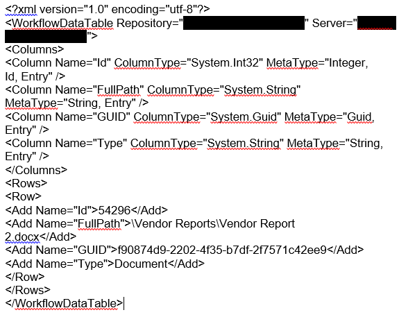

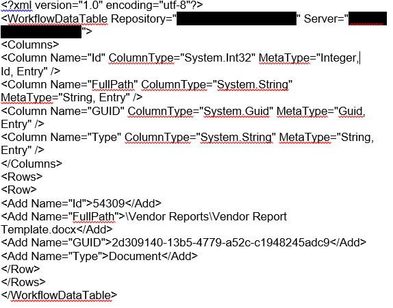

Workflow runs without error, however the resulted file is not a table populated with data from query result as expected (23 records should be shown).  Instead the following report is saved in the repository
Any idea what's causing this and any suggestion on how to fix it.

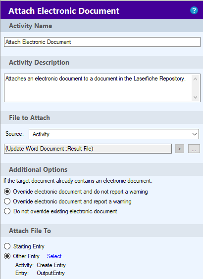

replied on May 8, 2020

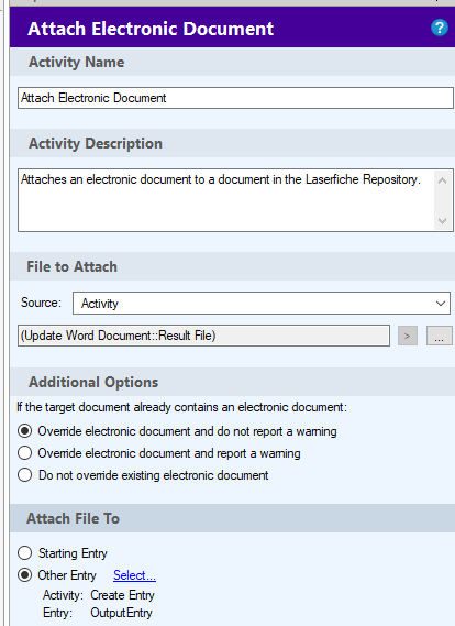

What is Attach Electronic Document set to use?
Word document
replied on May 11, 2020
I am using Result File from "Update Word Document" activity
replied on May 8, 2020 Show version history
Hi Naveed, it looks like you'll want to insert a Download Electronic Document activity after obtaining the search result in your first activity, and update the resulting file in the Update Word Document activity.
Edited to add: separately from the XML output, you may want to check that your TableStart and TableEnd fields are also merge fields so it can identify the merge region.

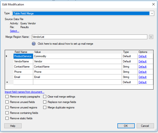

I used the tried the following Word tables but getting the same result. Any suggestion.  Thanks.
Hi Naveed, could you post a picture of your updated process flow so I can take a look at the settings you have for your inserted Download Electronic Document activity?
Hi Anita,
I  am not using Download Electronic Document Activity.  I am using "Search Repository" Activity to get the document and then use this document as a template in "Update Word Document" Activity".
Hi Naveed, I understand your process flow. In order to get the document to not be an XML, you will need to insert the Download Electronic Document activity into your workflow after your Search Repository activity, then point the Update Word Document activity to the downloaded file.
What Anita is saying is that you likely set Update Word to use the results set from Search Repository. That is actually the list of results (which is the XML you're looking at) not the Word document that was returned by the search. Search Results are meant to be used with For Each Entry, so if you want the actual electronic document for the search hit, you will have to use Download Electronic Document to get it.

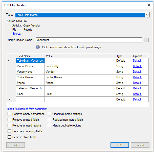

TableStart and TableEnd need to be merge fields like the rest of your fields. They seem to be static text in your screenshots.
If you don't want a separate column for your TableStart and TableEnd, you can also insert those merge fields into the first column you actually want to populate. It should look somewhat like <<TableStart:VendorList>><<ProductService>> within that Product/Service column, as an example.

Hi
I made the suggested changes and still not getting the table populated.

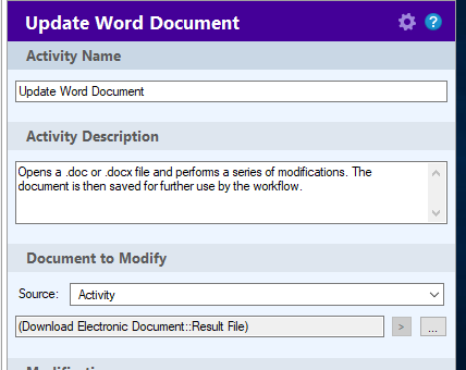

What file are you updating in your Update Word Document activity? Is your Update Word Activity using the file that's downloaded as the Source in the Document to Modify section?
I am using Result File from "Download Electronic Document" activity

replied on May 12, 2020
Hi Naveed,
Upon further inspection it looks like you have an extra space in the name of your TableStart/TableEnd fields. Because of this, the region name you placed in the Update Word Activity technically does not match the merge field name.
I'd recommend removing the excess space in the merge field, entering the format like the example I provided earlier: <<TableStart:VendorList>><<ProductService>> . You could also just insert a space before your column name in the Merge Region Name field in the activity.
Hi Anita,
Good catch.
The table in the word template is now populated with data from the query.
