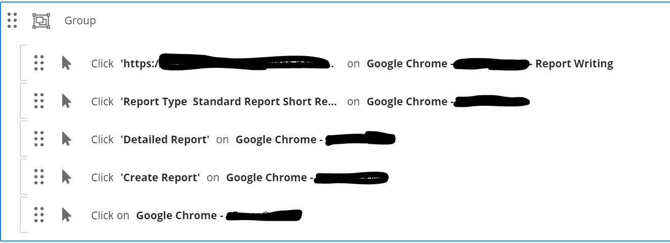

Unfortunately this is a Police Department records web application.
I tried this.  I can click on the drop down and then select Detailed Report.

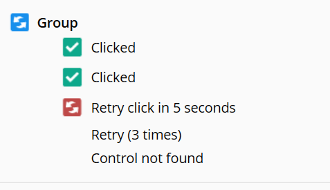

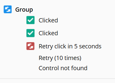

But when I try to run it, I get an error message that the control isn't found.

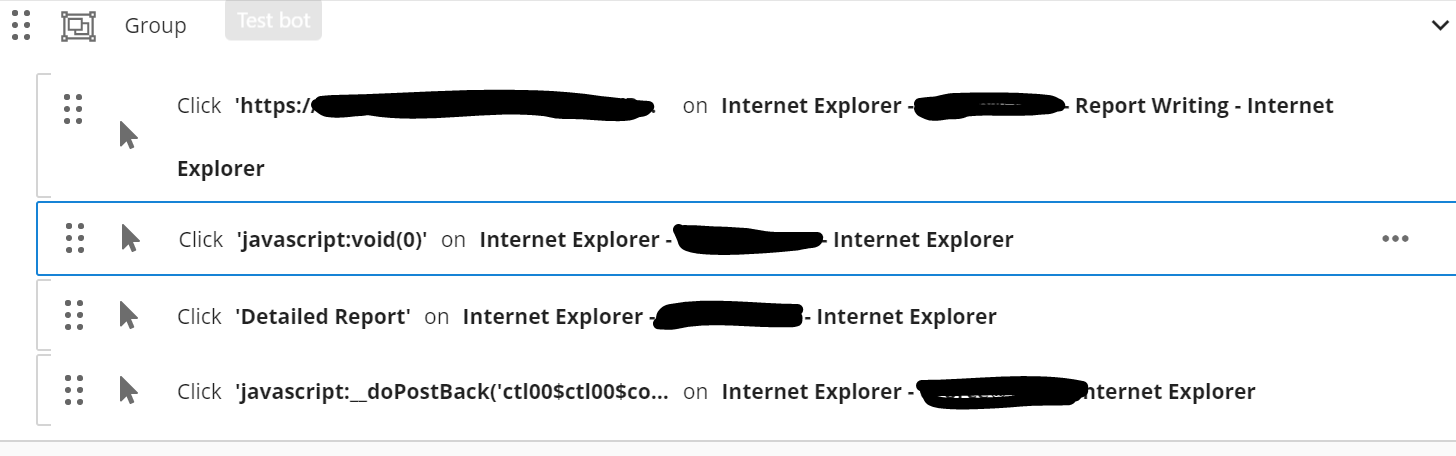

Tried the same thing in IE:

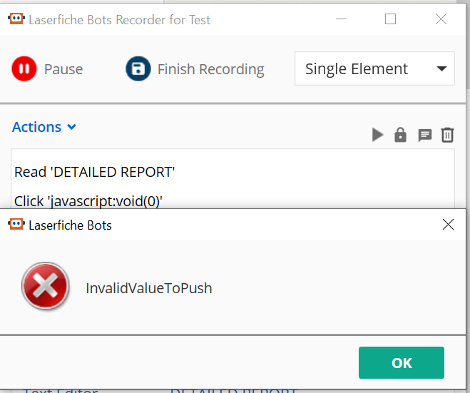

When I try to record copying and pasting into the field I get this error:
