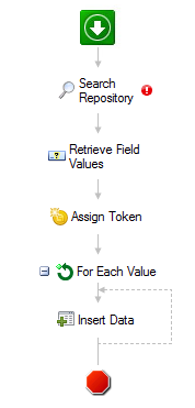

replied on May 1, 2020
Hi Naveed
In Workflow you will need to use either a Search or Retrieve Entries Activity to Target the Documents.
For there, you would use a For each Entry as you need to loop through the Documents you found.
Inside that loop, use the Retrieve field values to get the Template values for that document.
You'll like need another loop, For Each Value in the Multi-token Field and then an Insert Query to push it to the DB.
Here is an example

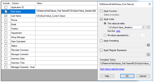

replied on May 4, 2020
When using a Multi-value token, each entry into the token tracked by an Index field, as in Line 1, Line 2, Line 3. When you insert the data, you can choose the value from the loop for the Current value of the Field selected (ie: Last Name), and then use the Token editor to pick the value from the other field (First Name) using the Loops iteration value as the index number.

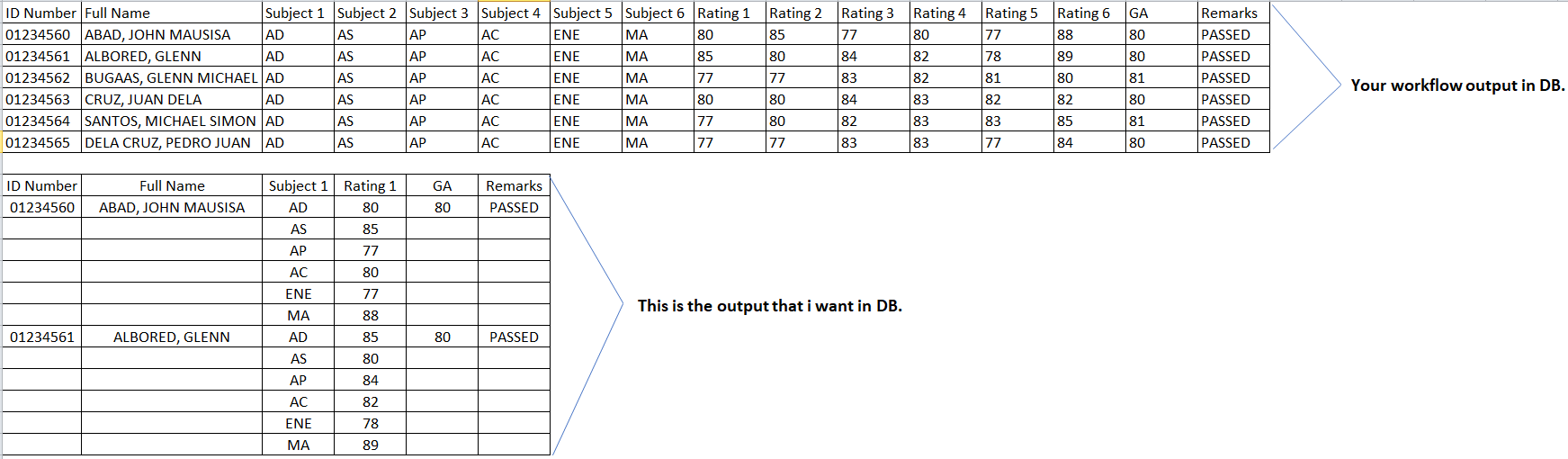

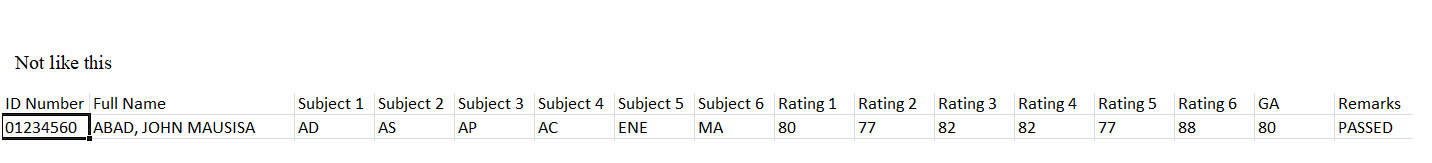

replied on May 15, 2020
Hi Steve,
I tried your workflow process and it works good.
But the output is different form what I want.
Please see the image below for your reference, for the output that I want.
I'm hoping you can help me regarding on this,
Thanks

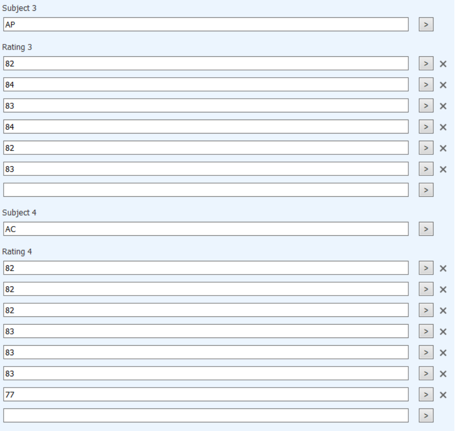

I Raphael
Can you send a Screen shot of how the Data looks in the Metadata Field Pane for a Document. Can be dummy data so you aren't sharing peoples info

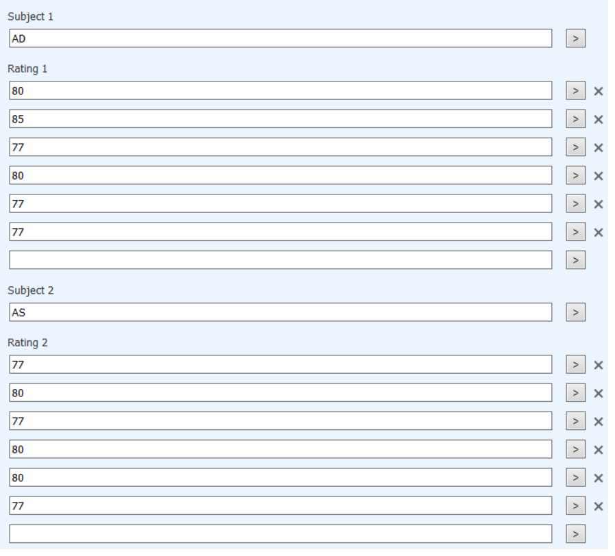

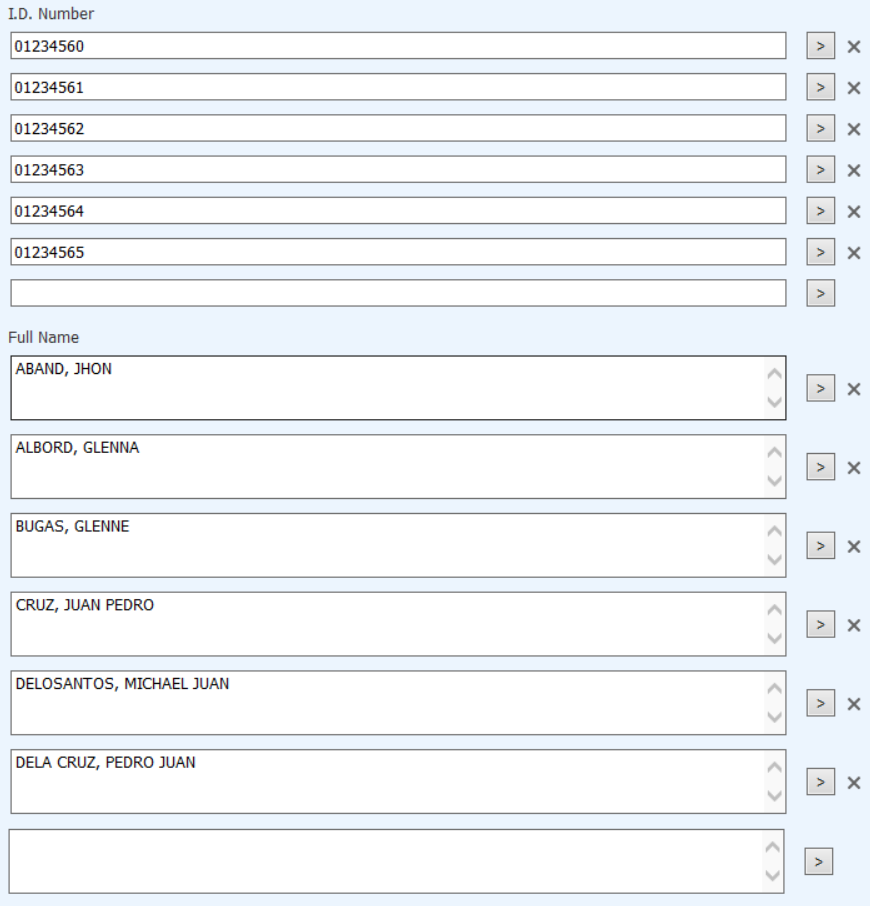

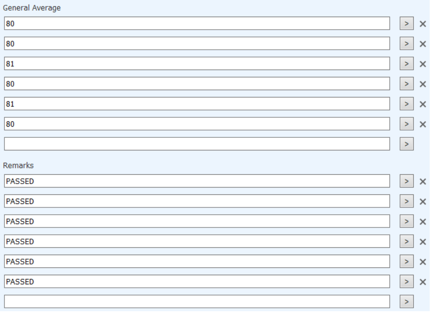

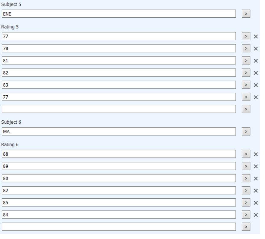

replied on May 16, 2020
Hi Steve,
This are the Screenshot that you asking.
Thanks

replied on May 18, 2020
Hi Rafael
This is fairly straight forward and only requires 1 Loop.
Once you retrieve the Metadata values I write all of the Subject values into a Token so I can use Index to pick the row. I am also using Index with the Retrieve Field Entries.
I used the ID field for the loop, and the iteration in the index to grab the Row data for each of the other values

replied on May 19, 2020
Hi Rafael
As you have Multiple Rating fields (1 to 6) with each being a Multi-Value field, I assume you are inputting all of those values in the Table, and you would the same technique as the Full Name field

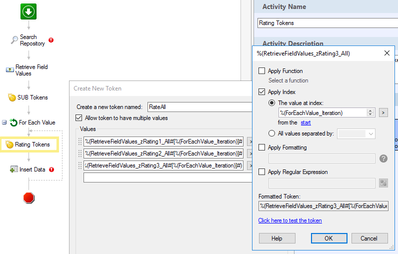

replied on May 20, 2020
Hi Rafael, I see your confusion.
Like the Subject Token, you would read the rating into a Token (RateAll), but this time you will do that inside the loop so you can accumulate Row 1 for all of the Rating Vales, then Row 2, etc, using the For each Value Iteraction to work down throw the row data on each loop. When you write to the table, you will write the values from the new RateAll token as it will get refreshed on each loop
Here is the WF below

replied on May 24, 2020
Hi Steve,
It works fine and i get the exact output that i wanted. Thanks for the help.
