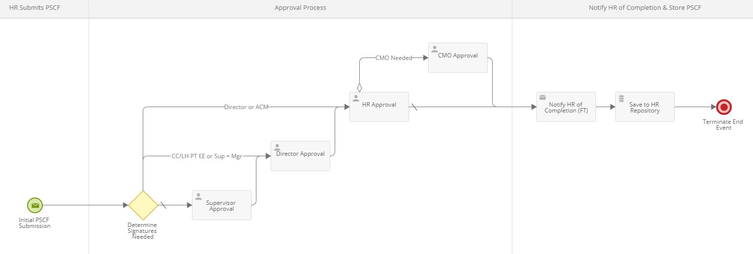

I currently have a form I'm building that goes through up to 4 different levels of approvals. The very first step in the process is an exclusive gateway that determines which signatures are required. I'd like to set it up to where if at any point in the process someone notices an issue with it, they can reject the form, at which point it will send it back to the initiator and prompt them to make the necessary changes, notify everyone who has approved it prior to them, and then send it back through the exact same process workflow a 2nd time for approval.
I thought this would be simple to set up but then I quickly realized the way I was doing it (via gateways) wasn't going to work due to having multiple inputs. In the below workflow, I'd like the revised form to enter the exclusive gateway and then proceed through the entire process (or a comparable process), but I wasn't able to make that work. Here's the workflow (with no rejection/re-run process built in):

Good morning Steve, and thanks for the response! The approvals happen sequentially: Supervisor > Director > HR > and then an optional 4th CMO approval.
The issue I ran into is that when creating a task for the initiator to make changes and then "submit back into [my] gateway", I keep getting an error: "The gateway named "Determine Signatures Needed" in the "Main Process" is improperly connected to other objects. Gateways cannot have multiple incoming and outgoing sequence flows." I cannot have a second input going into that gateway, even if it comes from a user task with the same form as the starting form. Any suggestions?

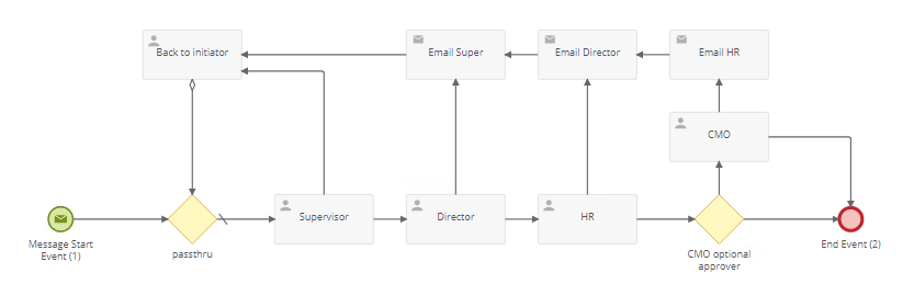

Hi Dylan
I think you could design it like this to get the results you are looking for
replied on May 1, 2020
That looks like it would work for the most part, with the exception of that very first gateway needing to have conditions that determine at which point in the process the approvals start. Based on data on the form, the supervisor or director approvals might be skipped, as you can see in the first screenshot I posted of the existing workflow. Adding that logic in means there's multiple inputs and multiple outputs to that gateway, which it doesn't seem to like.

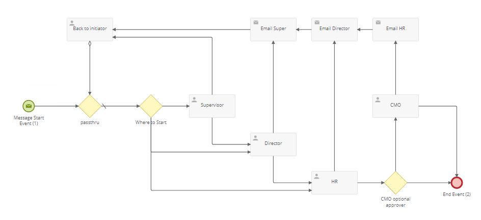

Hi Dylan
In that case, then we need another Exclusive gateway to make the decision regarding where to start.
As you noted, an Exclusive gateway cannot have multiple input so you would add a gateway on the path (no rule required) earlier such as below to get around this issue.
Regarding the emails going out when a rejection happens, that gets a little trickier not knowing to build in more logic as to should those who were skipped in the process receive notification anyways.

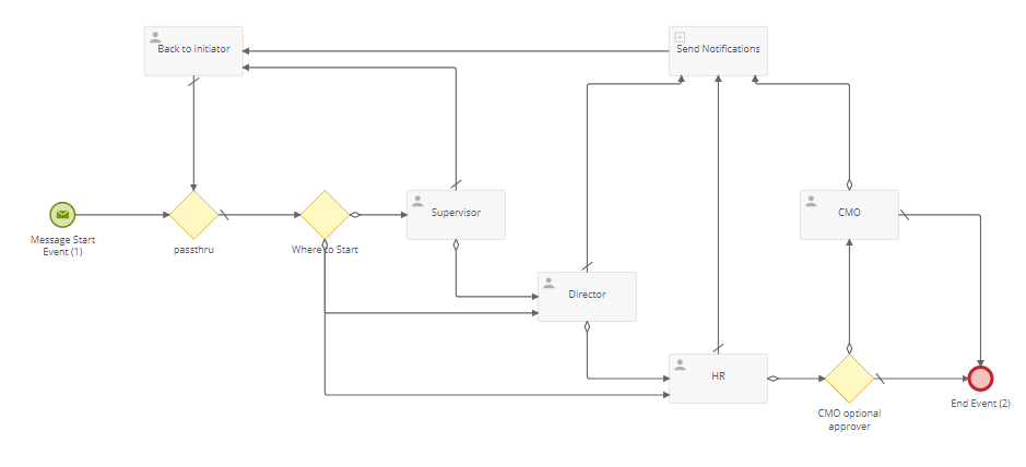

That could work for sure. I'm not a fan of more emails :)
If you wanted to have the Notification I think I would add a Sub-Process and build the email notification logic in there based on the same idea as your Where to Start Exclusive Gateway. Then all task would feed into it.
That would most definitely do the trick I think! I too am a fan of fewer emails, so maybe I'll go that route: Add a checkbox that can make a comment field appear with the changes that were made and request that they re-approve the form. I think that's a winning idea!
And I added that additional gateway into the workflow and it seemed to fix the issues I was having. That's such a simple workaround that for some reason I didn't think of. This is why I appreciate this community, haha. Thanks so much Steve!
