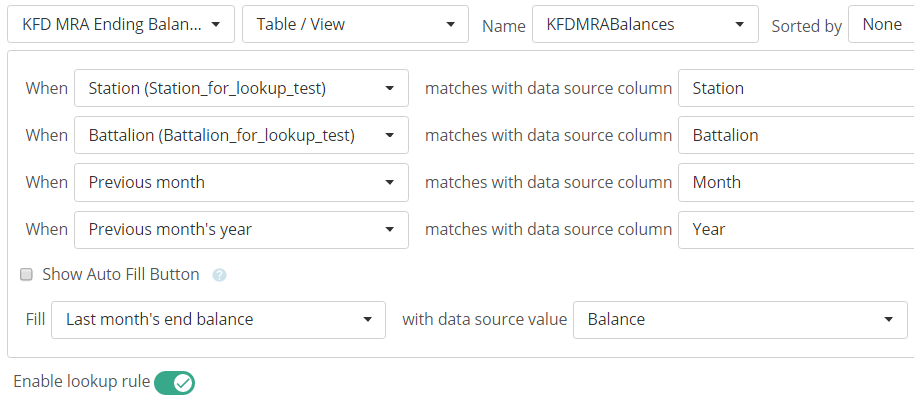

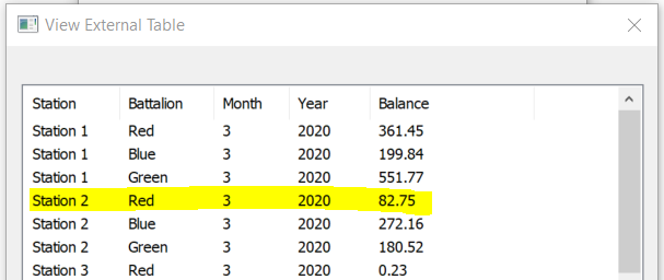

I have a simple table with a straight forward Lookup Rule to fill a currency field (also tried it with a single line field, which didn't work either) with a number from the "Balance" column, based on the Station, Battalion, Month, and Year selected in separate fields on the form.

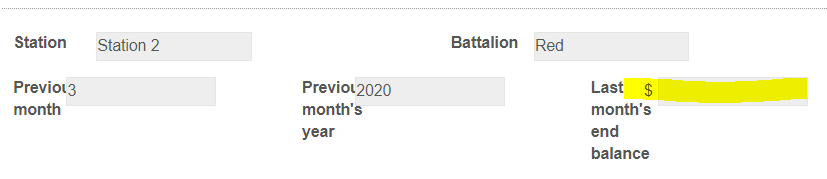

I can't seem to get the lookup rule to fill the balance field. Below are screenshots of the database table contents, the Lookup Rule, and the form with the highlighted 'Ending balance' field that should bring up the balance from the database table.

It appears that the issue was caused by setting the Section (that some of the lookup fields are in) to read-only. When I moved the Balance field outside of the read-only section, it still didn't work. When I unchecked the read-only box in the settings for the Section containing the month and year fields (which are criteria for the lookup rule), it works.
More about the lookup criteria fields... I had to calculate the previous month, and year of the previous month (in case the previous month was Dec of the previous year). On the form, the user selects the current month, and the previous month is calculated and hidden to look up the Balance for that previous month, and use it to populate the Beginning Balance of the current month.

I tried changing the data type of the Balance column. It appears that the issue was caused by setting the Section (that the balance field is in) to read-only. I unchecked the read-only box for the Section and it's working now.
replied on May 1, 2020
Oh, yeah the lookup rule was not able to read any data from the fields because the whole section was read-only.
