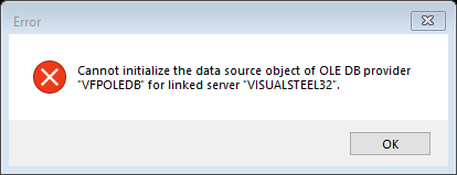

I manged to get an error.  This is query a view based on a linked server data source on a 32bit sql server.
