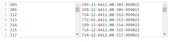

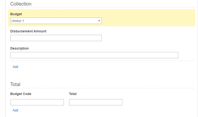

New to LF, feeling a bit lost. A lot of our business procedures revolve around 118 different budget codes. Education has to have different codes for grants and other federal funding. It's tedious, but don't really have any say in the matter.
Ex. of budget codes drop-down menu.
So far we have 2-3 forms that I have set up to act in the following matter. A collection field with the information needed, then they can add more and more trips or occurrences. (see below)
I can't seem to find a way to populate a table based off a collection response, i found some code to add a new row for every new budget selected, but not pass through info.

Id want a table that has column returning the full value of drop-down, and then added a total of all 315's. Next row is 316, so on and so forth.
I could do SUMIFs for each one, and hide if they are empty the problem is there's 118 different budget codes. so there would be 118 row table with most of it hidden 95% of the time.
Is there an easier way of doing this?

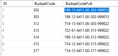

Here is the SQL table I created as an example

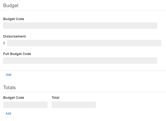

My Form Layout looks like this, same as you, Collection on the top, Table on the bottom

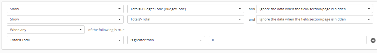

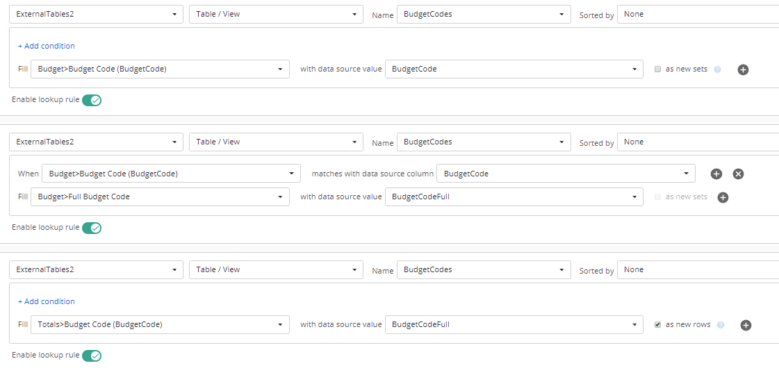

Field Rules (You will get a Yellow warning with this as it's hiding a field used in the Logic. There is a way to get around this by adding another field but it will work as you hope as is.
Lookups. The Lookups are used to Fill the Budget Code field with all of the Codes from the DB, and as well as the Totals Table. When the Budget Code is entered in the top form, it will populate the Full Code.

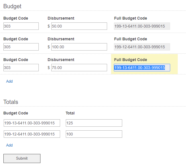

replied on May 1, 2020
Little video of it in action
Budget.mp4 (145.59 KB)

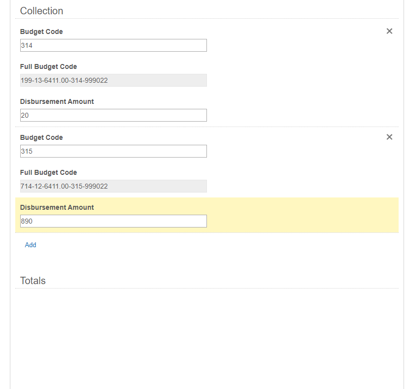

replied on May 4, 2020
So I created my on DB for now just to play around with it. I stuck with the single line as I agree it looks nicer and not as jarring.
I got most of it down, just the totals sum isn't working. It's also PRETTY laggy and not as smooth as yours, but that might be the sum field messing up some how.
I went ahead and just created a new form to play with it and modeled it after your example. Only difference I can see is my collection variables have a collection. in front of their name.
Here's what my sumif statement is. Which if I understand it correctly (explaining helps me learn)
=SUMIF(Collection.Full_Budget_Code,INDEX(Totals.Table_BudgetCode,ROW()),Collection.Disbursement_Amount)
This will add the Disbursement amounts from collections, where the full budget code (collection) matches the full budget code row in my table. Correct?

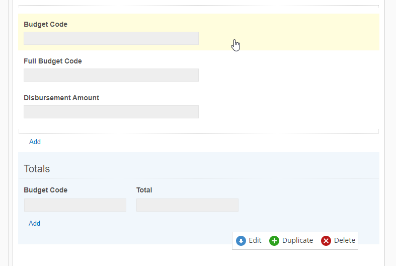

The last pic is what I see when I preview the form
Hi Dustyn, I don't see any Rows in your Table. The table needs to be populated via lookup from the same DB Table to create the Full Code list. This is what the formula is expecting. In the lookup section about, it was the 3rd lookup
Sorry Yeah i took off the hide rule after the fact. Here's a new Picture.

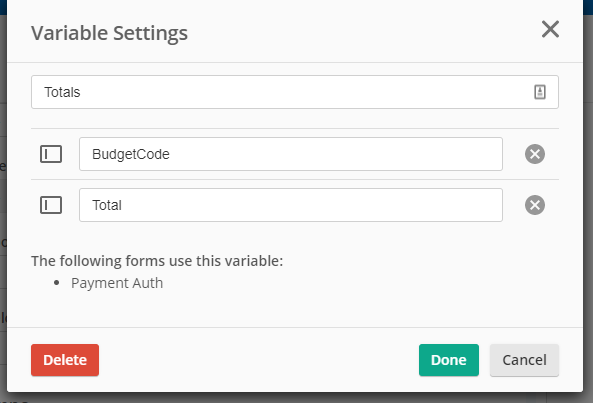

Can you confirm your variables, especially "Table_BudgetCode" as it doesn't follow the way you defined your other variables. Never mind, it would give you an error if the variable didn't exist

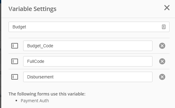

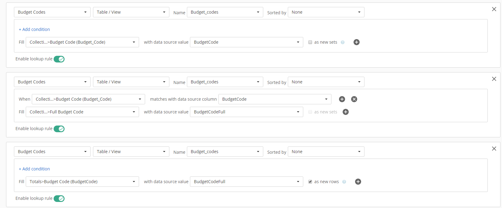

replied on May 4, 2020 • Show version history
Yeah, I thought that too, so I started messing with them as well. Just starting to mirror yours to get it to function at this point. See the new Sumif and Variables below. (and lookup rules just in case)
=SUMIF(Budget.FullCode,INDEX(Totals.BudgetCode,ROW()),Budget.Disbursement)
Collection Variables:
Table Variables:
