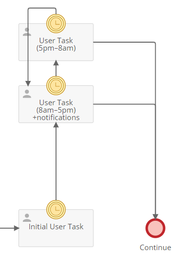

Hi Joseph,
You could have two User Tasks that the process alternates between and are otherwise identical. After you want the notifications to start, have the initial timer move to the first of these two tasks.
The first one will wait until 8am and then interrupts and moves to the second task. The second one has two timer events attached to it; the first timer sends a notification every two hours, and the second timer interrupts and ends it back to the first one.

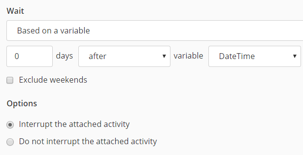

You will need a variable that's set (probably through Workflow) to be 8am on the day you want notifications to start, prior to Initial User Task.
For the time event on Initial User Task:
With the variable being the one I previously described.

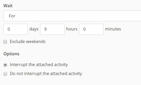

Then, "User Task (8am–5pm) +notifications" has the notifications every 2 hours, with a timer event to wait for 9 hours (ie until 5pm):

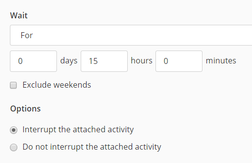

The process then moves to "User Task (5pm–8am)" where it waits for 15 hours (ie until 8am) and then moves back to the one with notifications:
