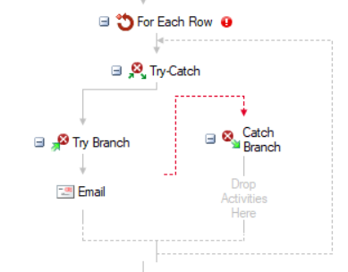

I have a list of 1000 emails and I need to send them a PDF. I'm using a loop for that.
In my list, some emails are bad (e.g : user@domaincom [no point]) and because of that, my workflow have some errors and it's normal but idk why, the next email is not treated.

Hi Olivier,
If you place your email activity inside of a Try-Catch this will handle an incorrect email.
This will run the Email activity and, if any errors occur, go into the Catch Branch where you can set up additional activities like emailing you a notification or something similar. It will then continue the workflow without terminating and, in my example, move on to the next row.
