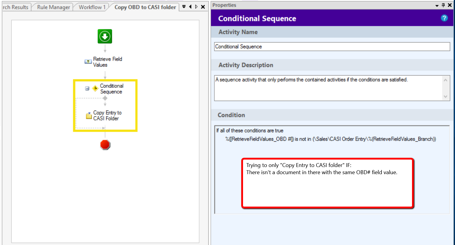

I want to copy a document to a folder. But I only want to copy it to the folder IF there isn't a document already in there with the same contents of a metadata field (e.g. Metadata field = OBD# --- Look at documents already in folder, if any document has the same OBD# as doc I want to copy, then don't copy it"

Use Search Repository to check if a document with the desired field value exists.

Can "Search Repository" look at a field for all documents within a folder? I want it to say "if any one of the documents in this folder has the same field value, don't copy the entry into the folder"

You can use Search Repository. To know the right syntax use LF Client Search and execute the search you want to perform. Once your search returns correct result, in search query options also add “Advance Search”. This will give you correct syntax. You can replace static values of syntax with retrieve field value tokens in workflow.
replied on April 22, 2020
Just being curious, how did you choose your field in condition #4 and you didn't select a profile to retrieve your metadata from in the Get metadata from drop down list on the top right?

This rule was written already before I opened it back up.
