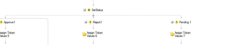

In your case you can use workflow to execute the actions needed on each step. So what i would do is create two workflows, one workflow for the approval and another one for the rejection.
Moreover, regarding the pending status update, i also prefer to create another workflow to set the status of the student's request to pending. This might seem a lot of workflows to create, but at least you organized your work in a way that your future troubleshooting will be much easier.
So again, i suggest the following:
  1. one workflow responsible for setting the value of the request status to pending. you just have to use the retrieve business process activity to import all the values of the form. and do the necessary actions on your database.
  2. After that, Using Laserfiche Forms exclusive gateways, split your process into two routes:
    1. One route handles what happened upon approval. Here you can create a workflow to process your data and do the necessary actions after approval.
    2. another route that handles rejection. Here you can create a workflow to process your data and do the necessary actions after rejections.

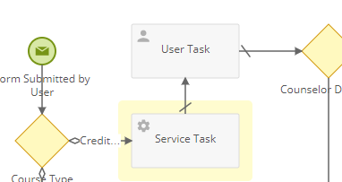

Ok so here is what i did.
I added a workflow Service task before the User Task. The workflow service task id is 24. (screen capture below)

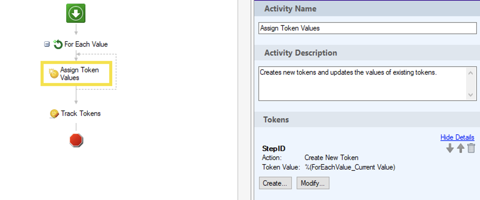

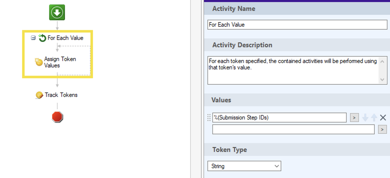

replied on April 22, 2020
Yes, you can use the "Submission Step ID". Remember that this token will give you multiple values and thus you need to set StepID token for each value which will ensure that in the end token contains that last value. After this, you can have conditions defined on StepID value.

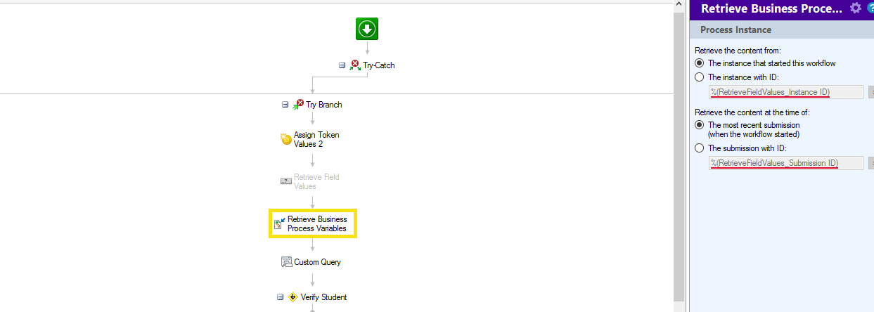

I have my Retrieve Business Process variables right at the start of the wf before the branches.
So as per the wf i have it set before it enters any branch.
Is there a way to keep the Retrieve Field values so i grab the instance ID and submission ID and use that in the Business Process Variable step  and at the same time accomplish The pending Status through the workflow task?
Right now i have the Retrieve Field values disabled and use the below option to grab the instance in the Business process variable. It's using just the instance so after Pending is captured and the approver approves/rejects it and comes into the wf it's looking for the instance ID again. The Business process Variables are not inside the branch where it's checking for pending or Approval/Rejection.
I hope am explaining myself clear.

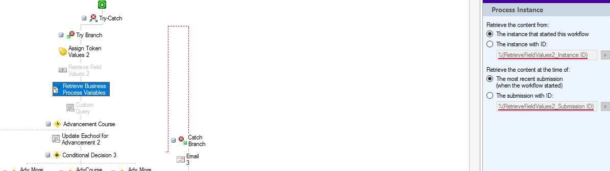

Alright,
  1. Try to move the Retrieve Business process activity right before the Assign Token Values activity
  2. In the Assign Token Values activity, create two variables: one variable corresponds to the Submission Id and another variable corresponds to the Instance Id as @Chandresh mentioned. Note: You can create both token in the same activity. give them appropriate names to identify them.
  3. Once these variables are created, assign the values of each one using the Retrieve Business process tokens.
Once these steps are done, you can configure your condition in a way to let the workflow decide which branch it should choose based on the values in your tokens.
replied on April 24, 2020
Thanks! Let me try.
So i went ahead and did the above suggestions. Created Instance and Sumbission ID in Assign Token values. And modified the token values by assigning the Instance and Submission ID And here is where i am.

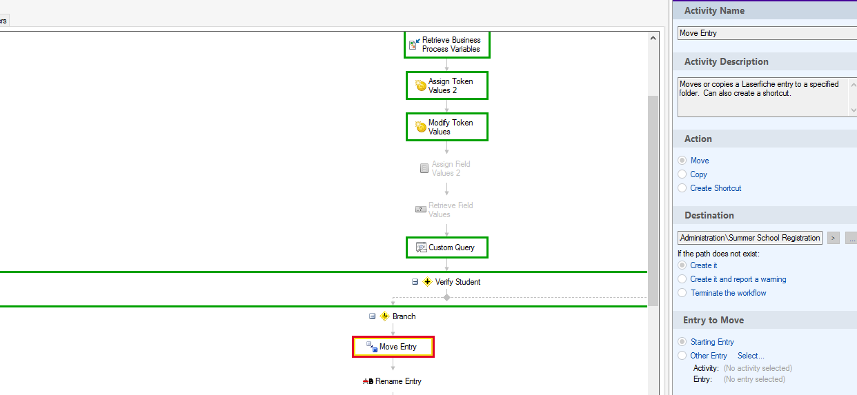

It's moved further down in the wf, but it's failing to Move the entry in the repository ("No entry was specified"). It will also fail at the Rename Entry for the same.
replied on April 24, 2020 Show version history
What is the error message provided by the workflow ?
In order to locate the error message, please click on the messages tab.
and here, what entry are you trying to move? because the way i'm seeing it is that you didn't specify an entry to move in first place.
The workflow is being started by Laserfiche Forms where there is no entries to work with. You have to use activities like Find Entry and Search Repository in order to locate and use these entries to move or rename ext...

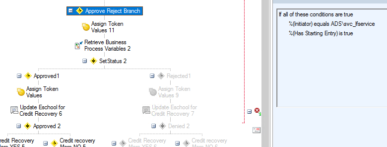

replied on April 26, 2020

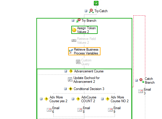

This is what i have and need suggestion on how i can handle it.

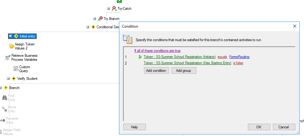

I changed some of my approach.....When the form gets submitted with a course selection i check in the workflow if Initiator is Forms Routing and Starting Entry is false. So it goes through the process, captures the Pending and updates the db.
When the approver picks it up and approves/rejects thats where i have an issue. AM not sure if am taking the right approach.

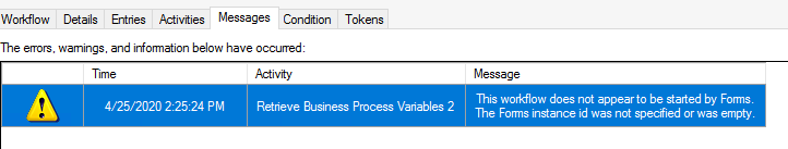

I have another branch (second screen shot below) where i check for initiator is svc_lfservice and starting entry is true , i retrieve the business process variables and assign the status as Approved/Reject.
It fails at the Business process variable step and errors ,(third screen shot below) How can i handle this?
ok Thanks so much for the suggestion . Let me try it this way. It’s better to take a diff route rather than getting stuck and trying to resolve it. Will keep the thread posted .

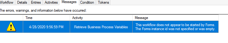

I see a warning in the workflow search when i search for the instance after the form submission . Any idea how i can get rid of the warning. It's functioning the way it should but i would like to fix/prevent the warning. Suggestions appreciated.
replied on April 29, 2020
Hello Rekha,
I'm really i could help in your situation.
As for the warning, if you are not using the Laserfiche Forms instance id or submission step then no need to check the Started By Forms checkbox. Uncheck it and i believe the warning will not show. But once again, uncheck it IF you are not using any tokens provided by this checkbox.
If you are using the instance id, then make sure that the instance id is returning a certain value. the warning is pretty self explanatory.
Other than that, i am glad u worked it out. Cheers!

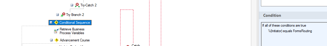

replied on May 4, 2020
No problem. Thankyou!
I included a condition check before Retrieve Business Process variable to check if the initiator is FormsRouting and that helped remove the warning.
