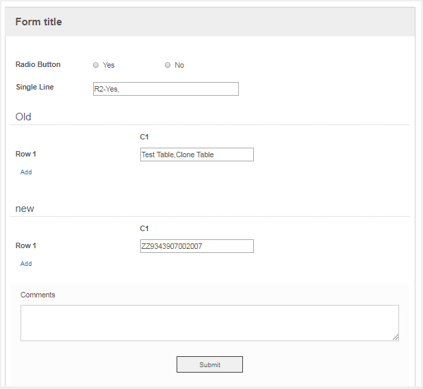

After Submitting the form the clone element or field is not been deliver to Next stage (approval stage).
Screenshot :

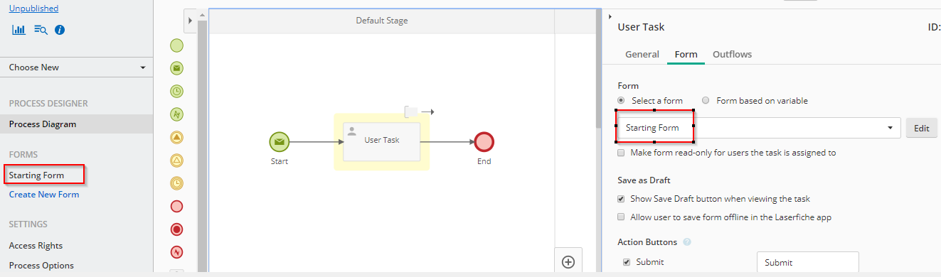

Screenshot of Property of Next stage :

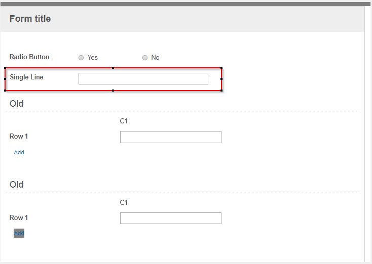

Screenshot :
On click of text field "Single Line" the cone of radio button get's created.

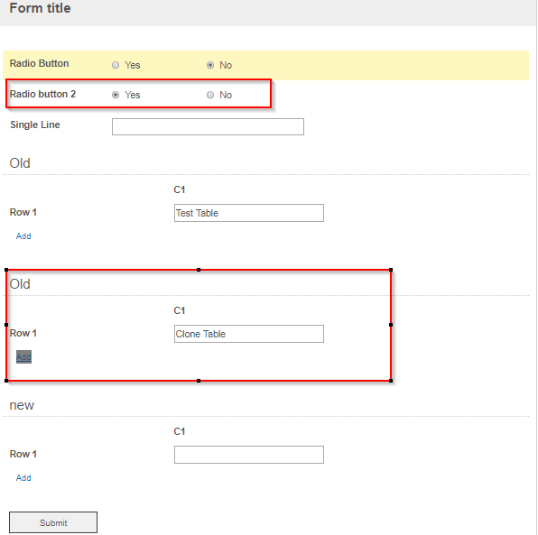

Before Submitting the Form all three alert ("test script1", "test script3", "test script4") where prompt properly and after clicking on "Single Line" field that clone code get executed with alert("test script2") message init.
Into Next stage when i open the Form only three alert ("test script1", "test script3", "test script4") where prompt the alert within the Clone code doesn't prompt.

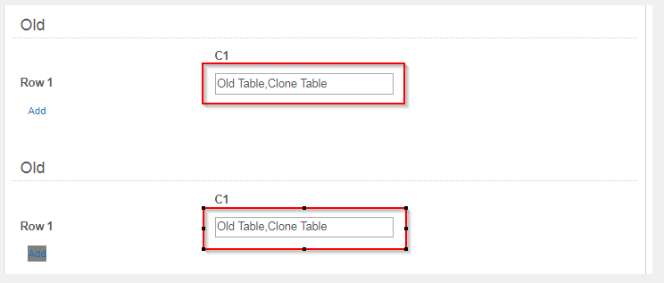

replied on April 22, 2020 • Show version history
1) Were located right after the alert("test script3"). Did it function correctly?
--> Yes, its working but what is happening is the data within the tables are getting repeated.
While Submitting :
After Submitting :
2) triggering the .click() function in the stage ?
--> It's working but value's are not coming. The behavior is same as above table.
