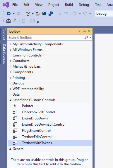

In the Visual Studio IDE you can add a tab to the Toolbox and add some native Laserfiche controls to your project.  One of those native Laserfiche controls is called TextboxWithTokens.  That control, when properly configured, will provide the functionality you need.

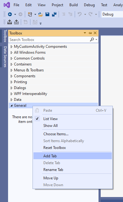

Right mouse click on the Toolbox in the Visual Studio IDE, select the 'Add Tab' option

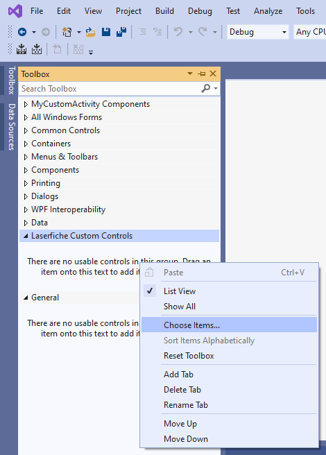

Name your tab something like 'Laserfiche Custom Controls'.  Right mouse click inside the new tab to get the context menu and select the 'Choose Items' option.
In the 'Choose Items' dialog click the 'Browse' button.  Navigate to the 'C:\Program Files (x86)\Common Files\Laserfiche\Workflow' folder and select the 'Laserfiche.Workflow.Activities.Custom.dll' assembly.
That will add several controls to your project.  The one you want is the 'TexboxWithTokens' control.
You can now drag/drop that control onto your custom control to configure it.
