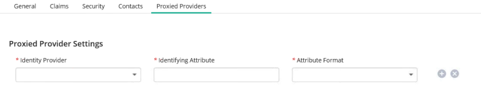

Hello,
I am working to get SAML configured and we have made lots of progress but we are unsure which attribute we are supposed to reference in this portion of the configuration. I reviewed the documentation, but could not find an answer to this.

That section is only required if you are trying to have AD users that are already registered in LFDS start authenticating through this SAML provider instead of using Windows Authentication. Is that what your goal is here?
If so, can you share what part of the instructions you are stuck on?
The relevant section:
Add the Identity ProviderIdentifying Attribute, and Attribute Format. Once finished, click Save. See the image below for an example.
  1. Identity Provider: Choose an AD or LDAP identity provider.
  2. Identifying Attribute: Make sure that the incoming SAML token contains the identifying attribute specified.
    Note: All Active Directory (AD) or LDAP groups must be included on the SAML token or their membership will be ignored.
    Note: Active Directory (AD) providers only support AD SIDs as a plain text string or Base-64 encoded.
  3. Attribute Format: Select an attribute format from the drop-down menu.
    Note: The SAML provider determines the Identifying Attribute and the Attribute Format. You can find this by looking at the SAML provider's configuration or intercepting the SAML Response generated for a SAML log-in to find the attribute name and format. The SAMLResponse is Base64 encoded. To learn more, navigate to Intercepting the SAML Response.
To paraphrase, the SAML token needs to include the SID for the AD user (or DN for LDAP), and the identifying attribute with that SID is something the SAML administrator should already know (because the SAML administrator must configure it), but you can also look at the token to verify on the linked page, Intercepting the SAML Response.

Yes, which is what those steps are intended to answer, so I'm trying to understand what part isn't coming across well. The Identity Attribute should be the name of the attribute where the SID will be found on the incoming SAML token.
Is the confusion how to find the name of the attribute within the SAML token? The name should be used exactly as it appears in the SAML token and the element is called 'Name' (not 'Friendly Name').

I think what you said in your first paragraph is what we were looking for, "The Identity Attribute should be the name of the attribute where the SID will be found on the incoming SAML token." The documentation does not specify that information. Thank you!

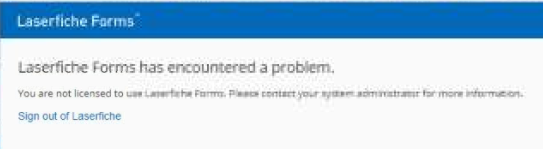

I met with the client and their SSO provider today and we have read through this and confirmed all the steps. When a user tries to login they are still receiving the message that they do not have a license to access Forms. Attribute is ADSID and attribute format is AD SID. when we ran a trace we found the values are passing but we thing the SID value may not be matching.
- They are using ADSID binary field. Previously they were using a string value, receiving a character error. That is not the case now.
- They are passing the object SID of the individual AD account. Is there a way to cross check this to see if there is a discrepancy?
