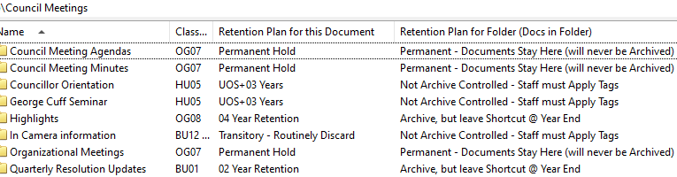

Here is how I deal with it.  These processes were decided upon when we realized that almost 50% of our records fit our Permanent retention category and I was spending too much time working on validating and handling these records for retention when if they were permanent, they could just stay in the TRM folders where staff put them.

WF2 – “Set Retention on Documents”
  • This WF runs all year long.  It will set the field called “Retention Plan for this Document” on every document, immediately upon it being placed in a folder, based on the metadata set on that folder.
  • Each time a document is moved from one folder to another folder, this WF will activate again and attempt to match the metadata on the document according to what is on the new folder.
  • Some folders hold documents with mixed retention expectations.  Those folders are currently being left blank for this metadata.
  • This WF is setting up for WF5, which controls where the documents end up in the archive sorting folder called “RECORD SERIES - Archive (incoming)”.
WF3 – “Set Archive Tags December 25th”
  • Every folder has a field that is set to control what happens with documents at the end of the year.  Do they get archived, or do they not?  Does the staff need a shortcut left behind, or do they not?
  • On December 25th, this WF will search out every folder and decide whether to set an archive tag on the documents, based on what choice was set on this metadata field.
  • This WF is setting up for WF4 which will do the actual work of pulling all the right documents (by looking for these Archive tags) into the Record Series folders where they need to be set up for proper retention.
