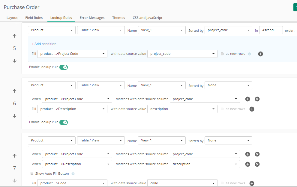

I wanted to look up the result of code , when project code = selected project and description = selected description matches the value.
For example if user select project code = HAN0027-042020 and description = Floorboard, so it must show WUD1022 as the value of code field.
I have set lookup rules as shown below. The result based on my lookup setup is showing empty code value. Kindly advise.

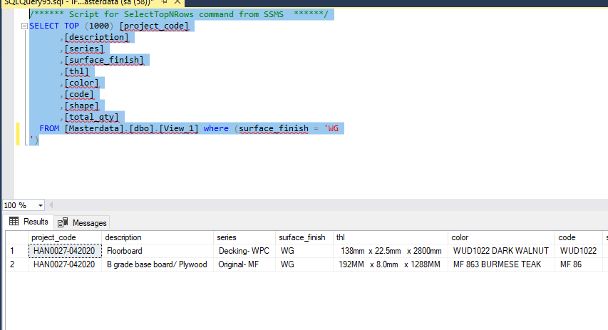

Execute the script on the management studio and see if you got the expected results.
E.g.
Select code from View_1 where description = 'Floorboard' and project_code = 'HAN0027-042020'
It should provide you with the result, and this will make sure that you've correctly define your lookup rules.
Also, I would suggest that instead of using a View, maybe you can use a StoreProcedure to accomplish this lookup. This will prevent in having several lookup rules.

How would a stored procedure prevent multiple lookup rules? The screenshot indicates they're using dropdown fields in a table and filling in the possible description values based on which project code is selected.
