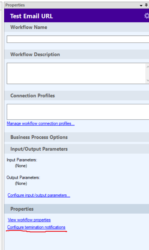

Hello, is there a way to configure a notification if an email activity failed?
Case use: manager enters email address for applicant but there is an error in the email address. As an admin I would like a way to push the failed notification to the manager instead of having to monitor the laserfiche mailbox for bounce back messages manually.
We are currently thinking about setting up an Outlook email rule to fwd those messages but I would like to see if there is some kind of workflow error catch option?
replied on April 1, 2020
Hi Cassandra,
This can be found at the bottom of the properties pane in the design view of the workflow, as "Configure termination notices".
It should allow you to do exactly what you're describing. Additionally, I believe Forms also added this in 10.4.3 in case you need it there too in the future.
