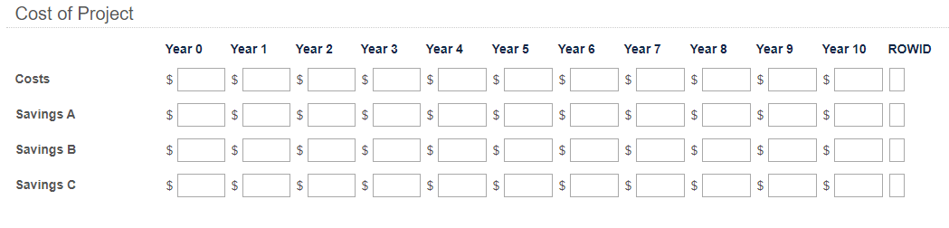

I have a fixed row table with four rows.  I want to multiply any values in Row 1 by -1, otherwise if not in Row 1, don't multiply by -1.  I'm thinking an IF statement with the INDEX function should work, but I'm not clear on the syntax.
Perhaps something like this:
=IF(INDEX(vProjectCost.Year_0,1),MULT(vProjectCost.Year_0,-1),MULT(vProjectCost.Year_0,1))
This formula doesn't appear to return anything, so I'd appreciate it if someone could take a look and let me know if I'm heading in the right direction or not.
Thanks.

Totals would need to a separate table or fields as you can't do that in your ProjectCost Table itself.
Seeing your table, there is no formula that would provide the Minus value across row 1. Possibly this could be done with JS, which is also how I would change the values to RED.
You could make Cost and Saving as two separate tables and just hide the Table Name and Fields using CSS which would still give you a look such as this. I would do the same thing for the Totals. If you did Cost and Saving separately, it would be easy to create the totals with a formula.
Myself, changing the Cost to Red would negate the requirement to have those fields as Negative but I leave that up to you

Manually populated fields.  It's for a Capital Expenditure Request, so there are ten Year fields to project the cost of the capital expenditure over ten years plus the current year (Year_0 through Year_10).  The costs go in row 1, and the projected savings, if any, go in rows 2-4.

The table needs to be able to show the Net of costs and savings. Costs would be a negative number and savings would be a positive number.  I will probably add another row in table for the Net calculation unless it works better as a separate group of individual fields or another table.
It's not just Year_0 that will have negative numbers; all columns in Row 1 need to be multiplied by -1.
