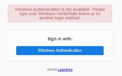

Follow-up question.  My original WebSTS is located on the Directory Server and is working appropriately (allowing both LF & Windows logins).  The new WebSTS is located on a different web server from the Directory Server and is configured to force Windows Auth.  However I'm getting the following error message:
"Windows Authentication is not available. Please type your Windows credentials below or try another login method."  Do I need to configure delegation for this to work or is this telling me something else?

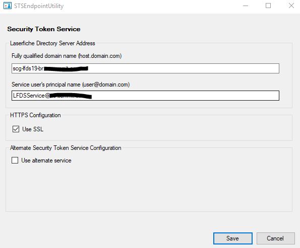

replied on April 1, 2020

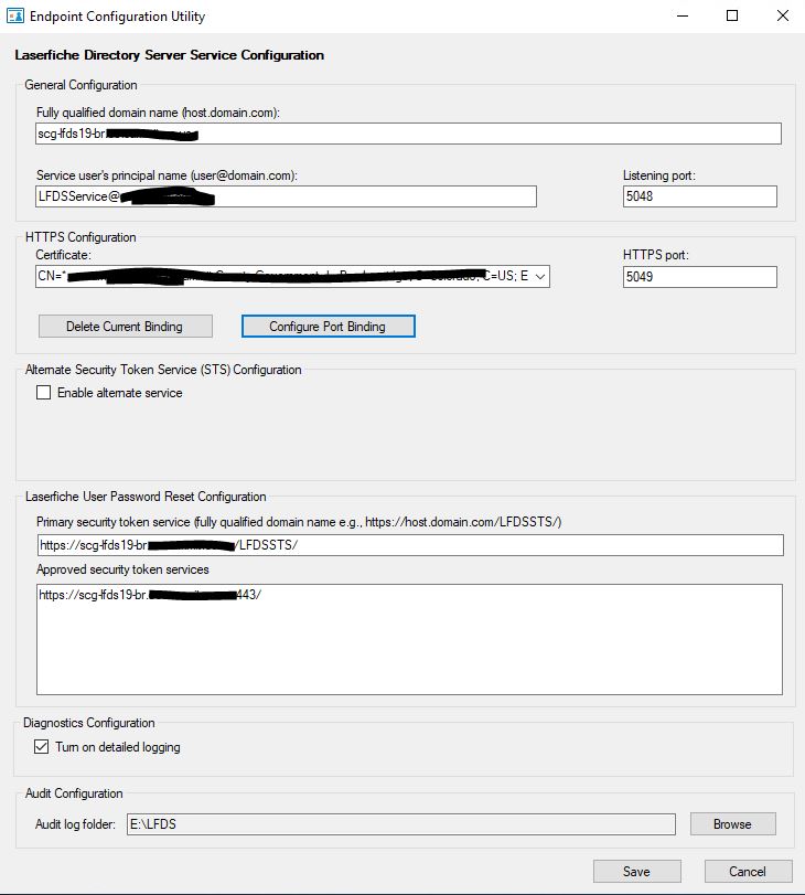

I've attached screenshots of the XML & STS Endpoint utilities.  The STS Endpoints look exactly the same on both the LFDS Server (this one works), and the secondary STS server (this one doesn't work).

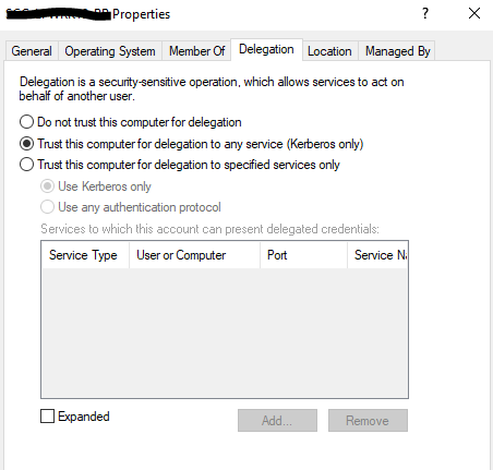

I had no luck with configuring it via the A.D. UI for the front-end server (even allowing all services), so I tried to do it for "resource based constrained delegation" using the following from the "Configuring Kerberos for Laserfiche 10 Web Products in a Windows Server 2016 and IIS 10 Environment" white-paper:
If the front-end service uses a computer account and the back-end service uses a domain user account:
$frontendidentity = Get-ADComputer –Identity WebServer
$backendidentity = Get-ADUser –Identity LaserficheServerDomainAccount
Set-ADUser $backendidentity –PrincipalsAllowedToDelegateToAccount
$frontendidentity
Still no luck....

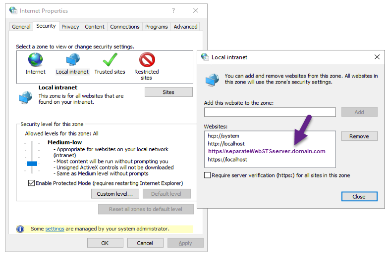

Turns out there's one more quirk of Kerberos delegation I didn't know about. It seems to only work when the site you're accessing is in the "Local Intranet" security zone, configured under the client machine's Internet Properties > Security settings.

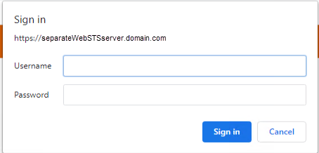

When you click the blue Windows Authentication button on the STS login page, do you get a popup asking for your credentials like so?
That indicates that the site is not in a zone configured for automatic pass-through authentication. After entering my credentials, I got the same error you did.
Once I got my STS site mapped to the Local Intranet zone, clicking the Windows Auth button automatically passed my credentials and successfully logged me into Laserfiche.
The security zone settings must be set for all client machines accessing the STS instance. It appears simple to push them out via GPO to end users if necessary: Securing zone levels in Internet Explorer (Chrome/Edge read the same settings).

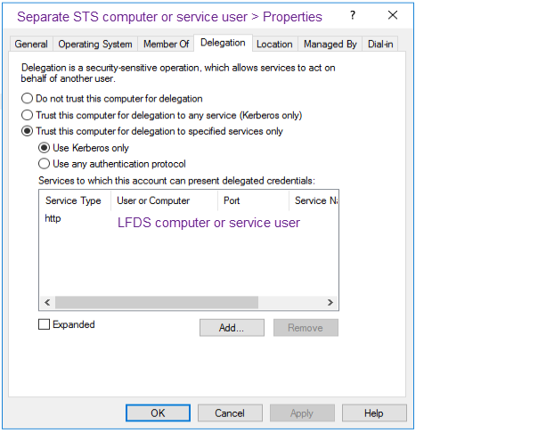

replied on April 3, 2020

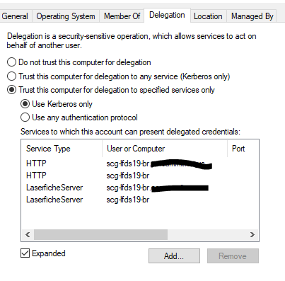

I've gotten it working with the delegation configuration below, however this isn't exactly ideal...
The LFDS service on the Directory Server is running under a domain account so I created SPNs for that Service Login for HTTP (and LaserficheServer as a long shot per the documentation), however that's not working (below)
I'm not sure where to go from here...

Hey John,
Do you need to run LFDS/STS as that AD service account (e.g. because you must use Windows Auth for the SQL connection)?
Running LFDS/STS under the default system accounts would allow you to use the config I had working above with no need to manually set SPNs (though you might need to undo the ones you added).
Laserfiche Server shouldn't play any role in this exchange.
