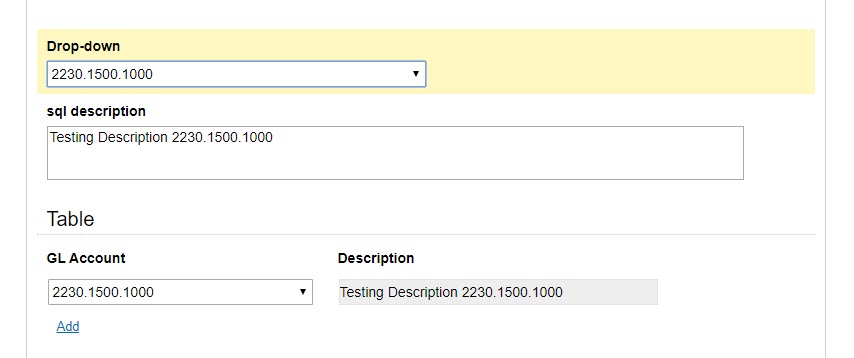

replied on March 27, 2020
I can still make it work in a table. And I made the description field read-only so no one could change it and it still worked.

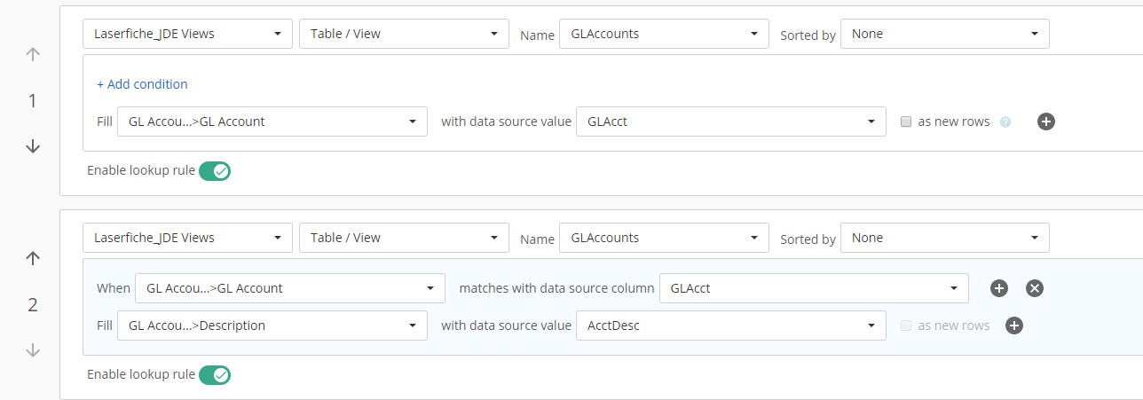

Can you post a screenshot of your lookup rules?  I can set up a lookup with periods and it works fine.

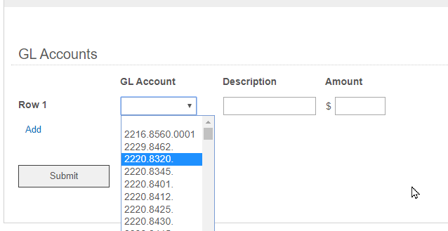

Screen shot of form with table.  Lookup rule should fill Description when account is selected.
Lookup Rules:

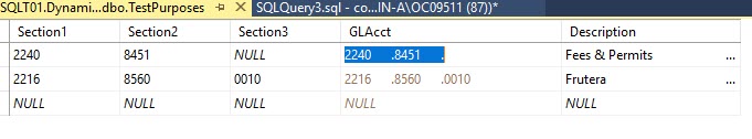

replied on March 30, 2020

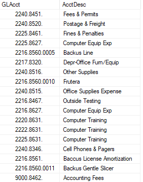

Here's a sample from SQL Server:
Both are nchar fields.  The GLAcct field is populated in the SQL Server table using the Concat function - CONCAT(BusUnit,'.',ObjAcct,'.',SubAcct)
I also tried this without the table and it still doesn't work.  I am also having difficulty in SQL Server just querying the same conditions and getting no results.  Perhaps it has something to do with the fields being nchar?  I haven't tried this before with the concatenation of periods to separate multiple fields so it's kind of a mystery at this point.

I believe Miruna is asking what length the nchar columns that feed the concat statement are.  When I recreate the table as nchar, I made them nchar(10) and that set a fixed value of 10 characters so my concat field does not look as expected.
That is expected behavior for nchar (the value is padded with spaces to the length of the field.
I would guess that is the problem here, the values are padded with spaces that are trimmed on the Forms side, so they're no longer matching.
Miruna; you are correct.  If I add LTRIM(RTRIM) to the fields before concatenating, the unseen spaces are removed and the lookups now work.  Thanks.

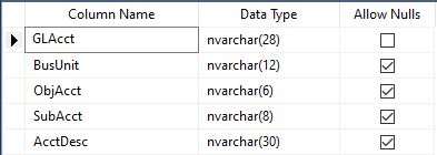

Here's the table in SQL Server.  It gets created from a SELECT INTO statement and the field data types are generated automatically.
SELECT
    CONCAT(GMMCU,'.',GMOBJ,'.',GMSUB) as GLAcct,
    GMMCU as BusUnit,
    GMOBJ as ObjAcct,
    GMSUB as SubAcct,
    GMDL01 as AcctDesc
Into GLAccounts
FROM
    ROMAINE.ROMAINE.PD920DTA.F0901

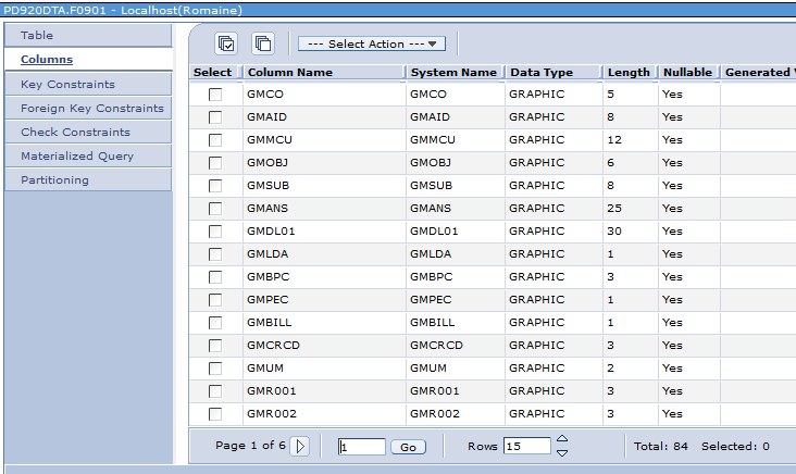

What are the data types in the source table ( ROMAINE.ROMAINE.PD920DTA.F0901 )?
All columns are data type GRAPHIC.
