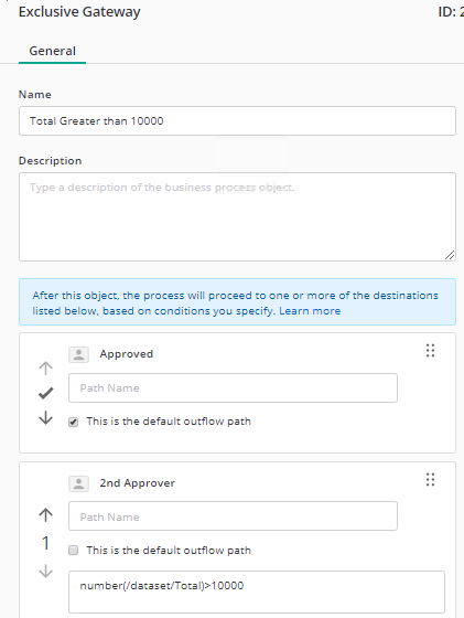

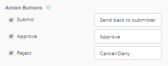

Hi Connie
It could look something like this, I'm using the Review Task with your three action buttons.
I am using a Field Value on the form called Total in my Exclusive Gateway to route to 2nd Approver if that value is greater than $10,000. If the 2nd Approver Denies I am sending it back to the review stage

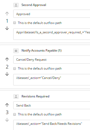

replied on March 24, 2020
Okay, so this is what I now have in the spot where you have your "number..." set up:  Appr/dataset/Is_a_second_approver_required_="Yes"over"
And it Terminated.  What should I change?
Is this your Action Buttons in your Task or your Exclusive Gateway?
I would not have the 2nd Approver in my Action Buttons, just Approve.
In your Gateway, it would look like
I don't know why your variable has Appr in front of it
This is in the Exclusive Gateway.  Ya, I think that wording is just a hang-over from when I had removed the Cancel option so I could have a pathway for the Second Approval.  That pathway is for the button that the first approver would hit "approve" on.

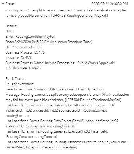

Okay, then!  So that's what happened, when I configured for the radio button, it must have popped into the word approver and I didn't notice!  appr at the beginning and over at the end.  I wondered what the "over" was for, but I didn't notice that it started with appr!  Will try another test now.
Okay, so in testing, if I approve with the radio button checked on Yes, it goes forward.  If I approve with the radio button checked on No, it Terminates.  Now that I think about it, I realize:  Of course!  I haven't told it what to do if the button ISN'T ON Yes.

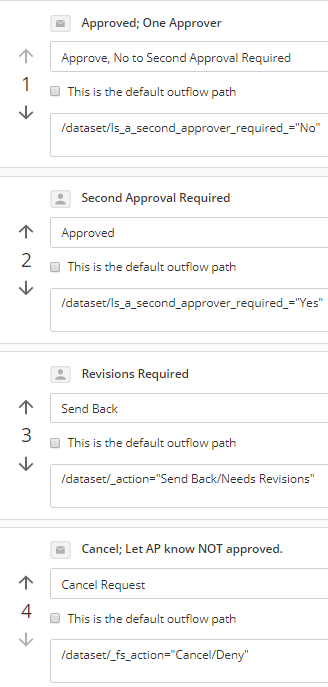

Great!  I didn't know you could put two in there!
You can have multiple outflows from a Exclusive Gateway. As it is Exclusive it will only follow the path that matches your condition (or the first one, if more than 1 matches).

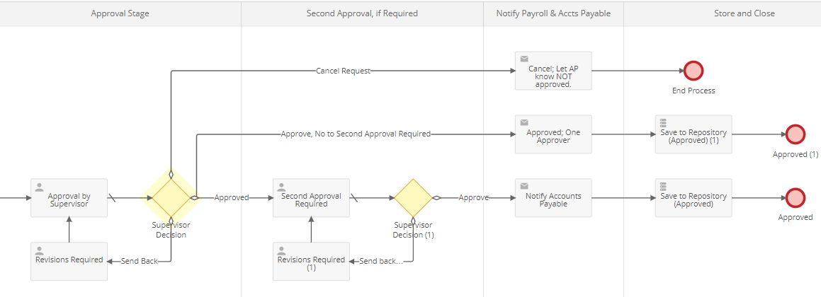

Success!  Success!  Yeah!!!!  Thanks so much, Steve!
This is the configuration that worked.  What threw me for a bit is I couldn't make the fourth option open up here.  It didn't show up until AFTER I connected the line between the gateway and another AP User Task for 1 approval.  When I went back in I saw the blank 4th option and was able to fill in the instructions.  YEAH!
