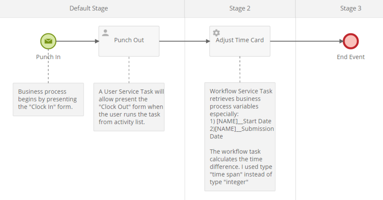

I would like to suggest build a Workflow Service Task within your business process.  Workflow will allow you to use a Script Activity to handle the time calculation.  Take a look at this post in answers.  Note: I have tried a few methods using Date Token Calculator however it is not well suited for this application.
This example uses two simple forms (identical except for names/labels):

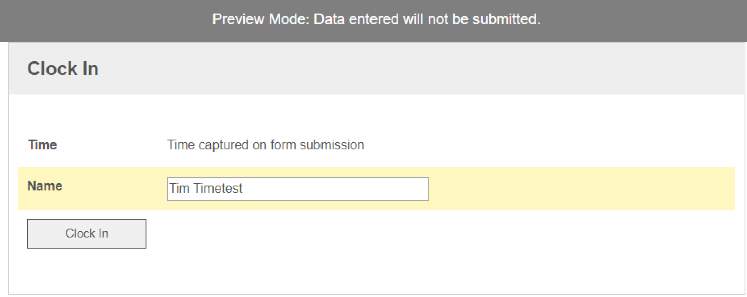

1) Clock In Form
2) Clock Out Form
Your application may be different however I have attached screenshots of a process and workflow that correctly calculated a time span using a script.
This process runs when started and presents the Clock IN form.  Once a user "clocks in" then the process begins a user task to "clock out" but must wait for the user to actually perform the action.  Once clocked out, the workflow service task can calculate the time difference.

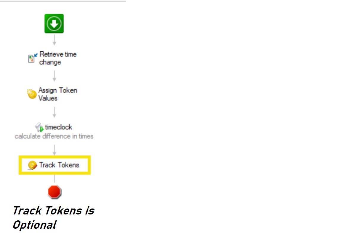

The workflow retrieves the business process variables, especially the two variables noted.  These values are of type DateTime therefore subtracting DateTime variables it makes sense to use TimeSpan type for the result.  The link at beginning of this post uses Integer.  Choose the correct value for your actual application.
1) Retrievetimechange__Start Date --> used as CLOCK IN time
2) Retrievetimechange__Submission Date --> used as CLOCK OUT time
My test script code:
When you use a Script Activity there will be skeleton VB Script code.  Insert your code directly below the lines that reads  "   'Write your code here.  " but above the "End Sub" within Sub Execute().
Dim ttimespan as TimeSpan
Dim starttime as DateTime = gettokenvalue("Retrievetimechange__Start Date")
Dim stoptime as datetime = gettokenvalue("Retrievetimechange__Submission Date")
